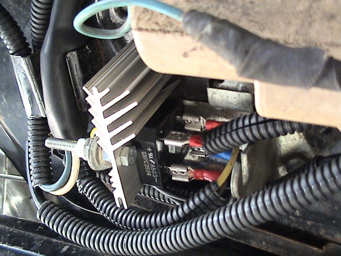

Post by brewsky » Mon Aug 10, 2009 5:01 pm
E3,
Thanks for yor help...you were right on the diagnosis!
Got the 25A Radio Shack model, robbed an old heat sink out of an old computer, a little wire patching and she started right up.
Puts out about 12.9 volts no lights and 13.5 volts with lights revved up a little.

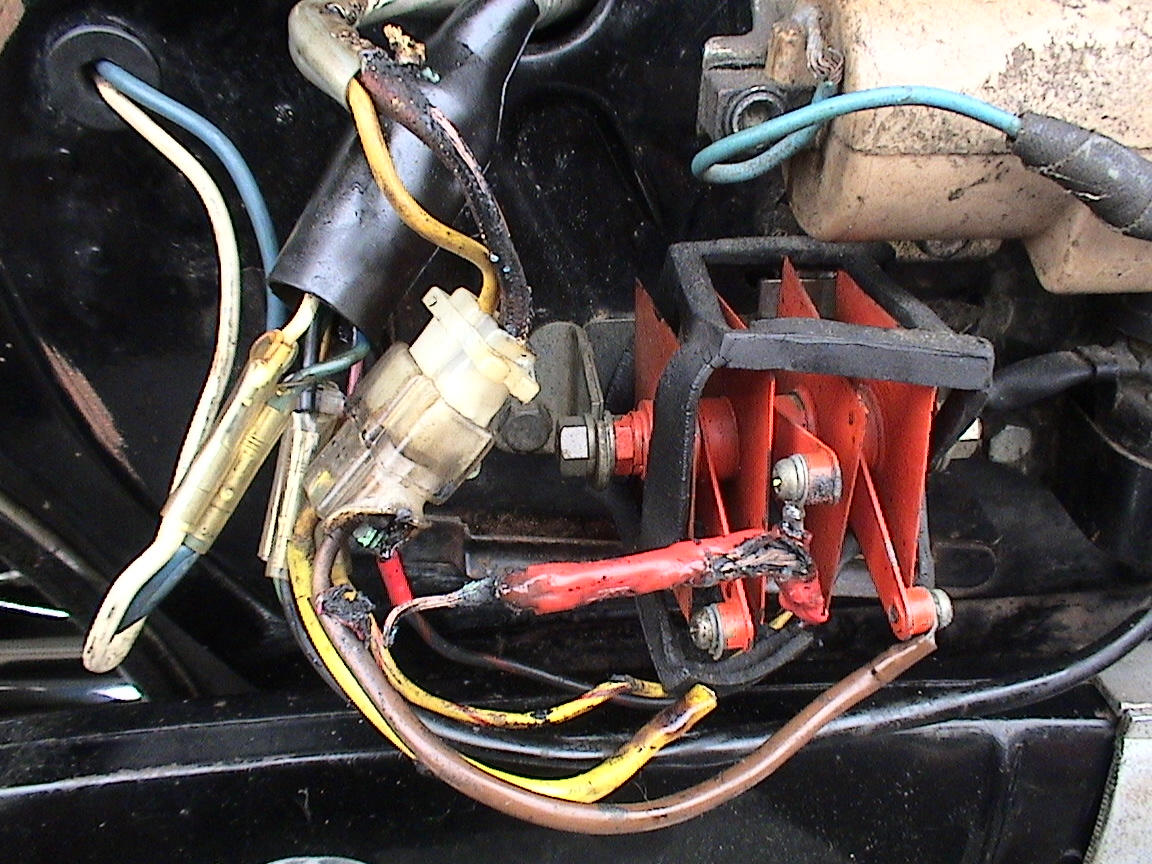

Before and after pics below:
BEFORE
BEFORE
AFTER
AFTER

Nice work! If you ever want to go back to the stock look, Retro Bikes makes a new (non selenium) rectifier that looks like the genuine item.

Sweeeeeeet. Nice job! Good to see others using decent protective sheath over the cables. One observation: I'd be inclined to change those uninsulated push-ons for the insulated variety..... Better safe than sorry, me ol' mate!

E3, you are right again on the connectors, I just tend to use what's laying around at first. Eventually I will get or make up a new harness front to back.
