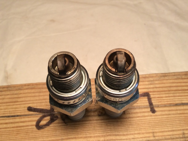

More fiddling today. Begin again. Needles on 2nd notch. Starts and idles good. Plugs beginning to color tan/gray at 10 minute idle. On test run, bucking at 3 - 4K rpm. Some popping. Reset Sachse to #4. Ran again and had bucking @ 4K rpm. Plugs getting tan/gray. I'm thinking that this is a timing issue. Will reset Sachse. If that doesn't work I'll try the mechanical ignition. Perhaps there's electrical interference with the Sachse wiring through the stator coils.
Edit:
Later. Reset the Sachse timing, but same result. Reconnected mechanical ignition and it runs like a champ. Took a longer ride without issues. Plenty of pep and power. And that great exhaust note. Plugs developing a nice color. Right side just a bit richer. More tweaking later. For now, the Sachse unit will remain in place, but disconnected. Eventually, I'll reroute the sensor wiring externally and see what happens.

I finally got the Sachse ignition up and running today and took a long test ride. I'm happy to report that - so far - I have not experienced any difficulty with the sensor wire running through the stator. I'm running the unit on profile 4, but will be trying others each time I ride. I've also finally gotten the carb set correctly and both plugs are a grayish tan. The rectifier/regulator continues to function well and I've removed the Kisan volt/amp meter from the handlebar. I might take the old girl to a local classic bike show next month.
