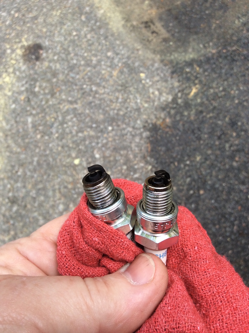

I stripped the carbs, cleaned everything again and reset the floats. They seemed a tad high. Using LM's adjustment method, they needed to go down just a bit. Reassembled carefully, synced the slides, and checked the timing, which seemed ok. VERY hard starting. the choke is not helping; got a few backfires through the right carb. When it finally started, it seemed to run ok and I had it idling at about 1k. Adjusting the air mixture screws had almost no effect. I started it again later in the day with the same difficulty. I shut it down after it was fully warmed up and pulled the plugs. They were dry but somewhat dark with carbon (see pic). I believe this indicates too rich a mixture, but idling for so long could do it too.
Tomorrow, I'll raise the needle clips to 3rd from the bottom tomorrow to see if that might help and get me some level of adjustment with the mixture screws.

Post by LOUD MOUSE » Fri Jun 03, 2016 6:36 pm
Remove the tubs you have on the bowl VENT. ..............lm

Post by Seadog » Fri Jun 03, 2016 7:14 pm
I'll do that, LM. Will you tell me what that will do?
Post by LOUD MOUSE » Fri Jun 03, 2016 7:23 pm
Allow air to inter the carb as required to balance air in and fuel level. ..............lm
Seadog wrote:I'll do that, LM. Will you tell me what that will do?
