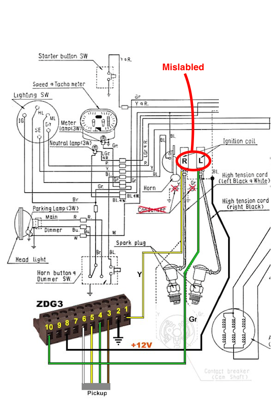

Uh oh, I was just looking looking at the Honda wiring diagram and comparing it to the Sachse modified wiring diagram. What Sachse labels as the right and left coils are opposite to what Honda calls right and left..... Have to get back to today's busy program but I'll return to this later. Interesting turn though.

Well, it turns out that the Sachse wiring diagram IS mislabeled. See the picture, below. I switched the wires at the coils and it started with the slightest touch of the starter button. Carbs still need adjusting; the idle is way too high. Once I have that figured out and it's running well, I'll try reinstalling the Sachse sensor wiring through the stator again.
