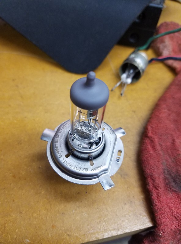

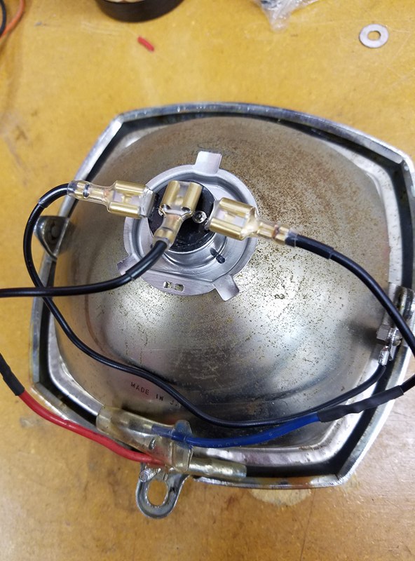

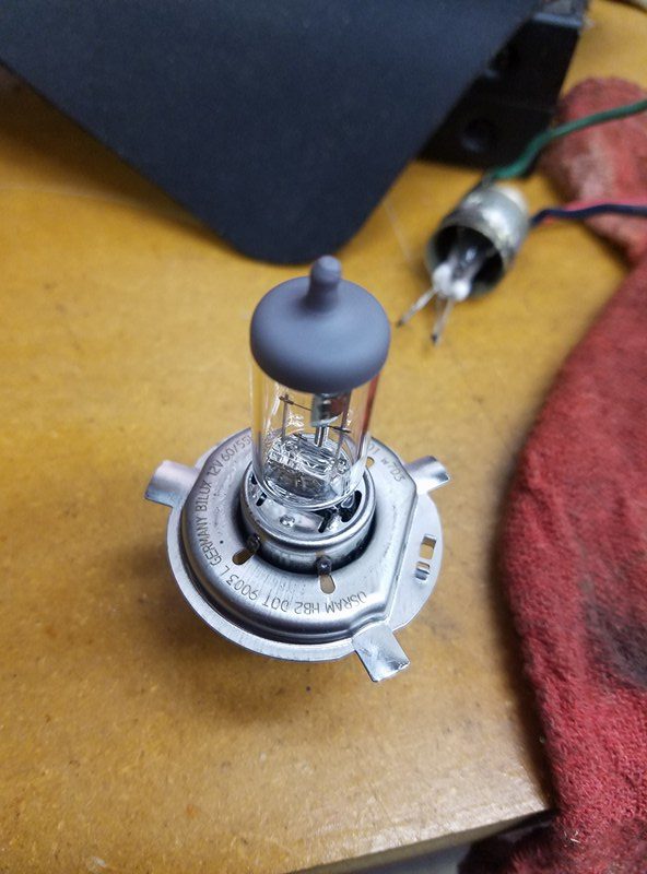

As part of my "winter projects" I did the conversion a couple weeks ago.
All together it only took a couple hours - to assemble.
The time was spent doing the research....waiting for epoxy to dry etc :)

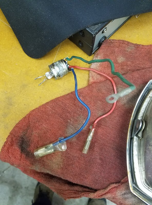

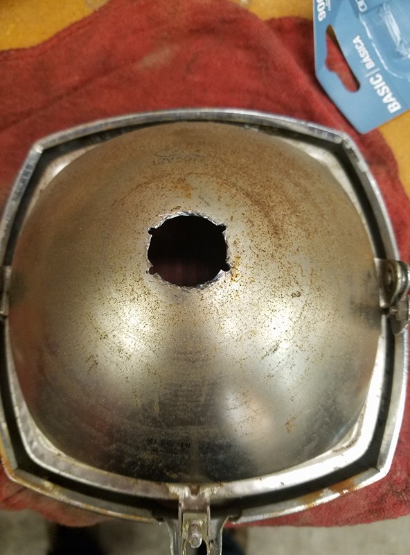

Cutting the old bulb out is easy...once it's loose you squeeze the base and the bulb pops inside the assembly...
Clean the glass out, clean up the hole, get your JB Weld mixed up and set your bulb.

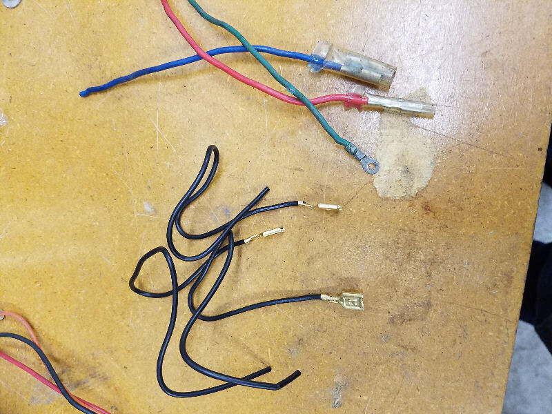

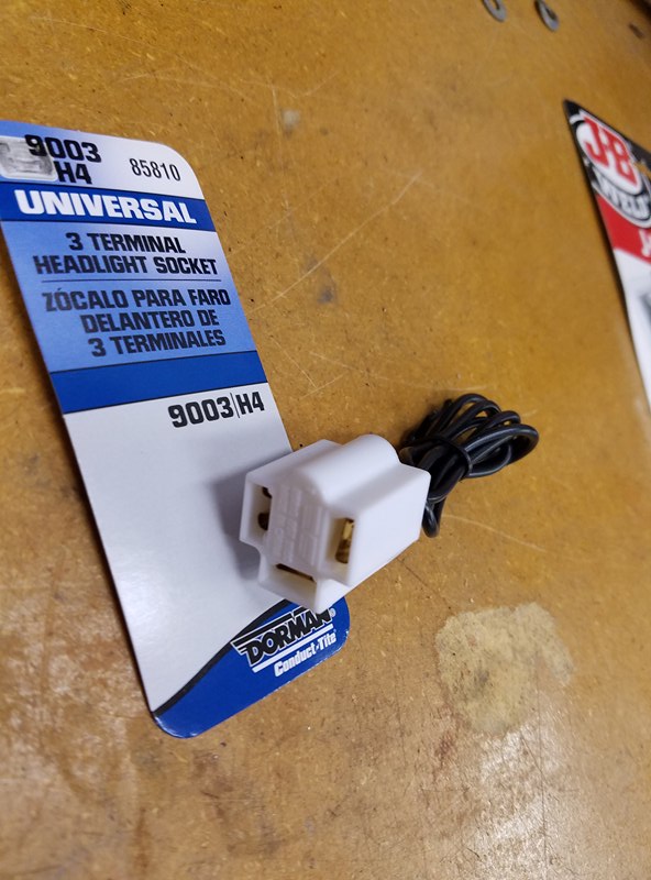

I found an inexpensive 9003/H$ bulb plug at the local FLAPS....with a tiny screwdriver you can depress the tabs and release the spade connectors from the plastic.
From there it's just match things up...a little soldering and heat shrinking...and a nice new super bright headlight !
Dan

Finished
Posts: 1273
Location: Cape Cod, MA
Post by Seadog » Sun Jan 07, 2018 11:33 am
Not bad. So you epoxied the bulb right to the back of the lens?
