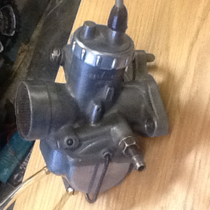

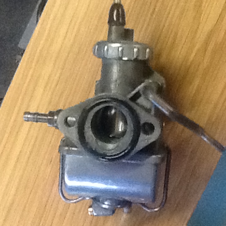

Post by Geoff Hastings » Sun Sep 03, 2017 11:26 am
Hi G man, Second attempt at posting photos, the system did not like the high definition so apologies for these slightly poor pics

Post by Geoff Hastings » Mon Sep 04, 2017 7:15 am
G-Man wrote:You really need to get the correct part for your carb if you want it to run correctly. The differences probably affect only the slow running circuit.
https://www.davidsilverspares.co.uk/par ... 211259020/
Hi Graham, I phoned David Silver and got conflicting information so I've taken a chance and just ordered the one using the part number you gave me. It won't be the end of the world if it's wrong.
Geoff Hastings wrote:
Nick wrote:Whatever insulator you end up using, better check it for flatness. Had mine off a while back and discovered that it was warped.
Thanks Nick, always worth checking including the carb flange for distortion. I've had a closer look at the pictures on eBay and it would appear that there is also a tiny hole drilled in the insulator, does this hole connect to the semi circular groove?
