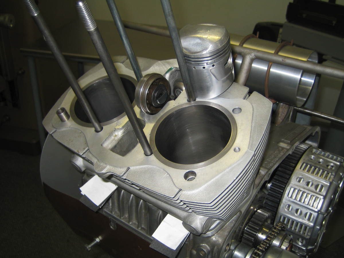

Post by G-Man » Tue May 12, 2015 6:46 am
You could try pushing out to 500cc..... :-)

So I sense some sarcasm, but after watching some videos of people running 500cc CB77s, I am curious what it takes. Same crank?
Post by LOUD MOUSE » Tue May 12, 2015 7:55 am
I know of a feller who uses CB450 crank.
See the gear driven clutch?
Compare piston to bore size!
Notice web added between the cylinders?. ...................lm
