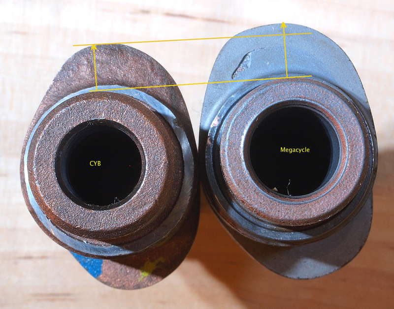

I have one half of a CYB cam and I'm going to get another half match to suit. I want to try in in a CYB race bike.
This is the CYB cam compared with the most radical Megacycle cam. I believe that the CYB cam offers longer duration but no extra lift..
You can just see the shadow of the stock cam in the Megacycle image....

Please show the bottom profile as that is where the follower/cam make the duration change possible. ........lm

I took those photos a couple of years ago. When I am back from my next trip I'll get the parts out and take some more pictures.

Good deal.
Not everyone knows what happens to a stock cam to make it longer duration. .........lm
