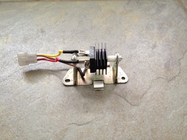

Here's my take on a replacement rectifier for my CA78. Works well and looks close to orginal.
Digikey 641-1383-ND - 1,000V 50A bridge rectifier
Ebay heatsink - http://www.ebay.com/itm/310744940609?ss ... 1439.l2649
Original wiring harness and mounting hardware. $10 all in.
