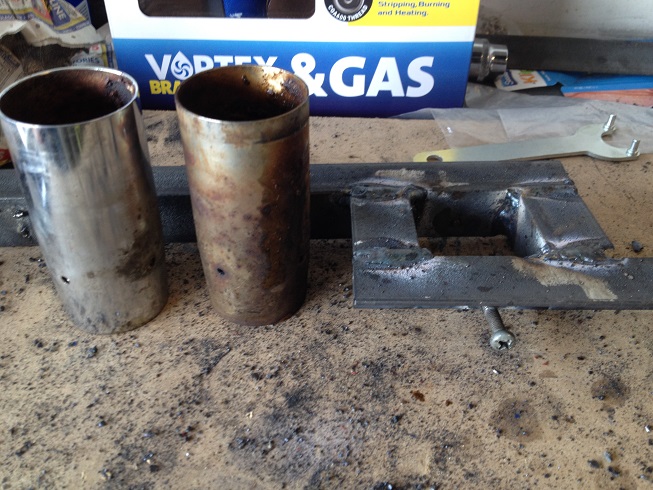

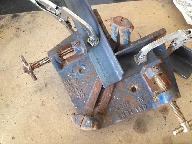

Post by eddiebpool » Sat Apr 15, 2017 9:44 am

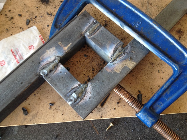

I done the best I could with my typically crude and over engineered way. I started off with some 3mm angle steel and cut the long parts 300mm for a bit of leverage and the short parts 55mm to give a little wiggle room on the inside. I have a vintage clamp to create 90degree angles. I created two "L" shapes with the old clamp, g-clamped them together then welded them up. Please don't judge my ratty welding, it isn't my best skill!
eddiebpool
Posts: 16
Joined: Sat Mar 25, 2017 6:38 am
Location: Scotland

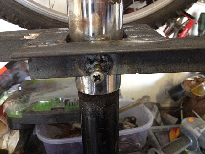

Post by eddiebpool » Sat Apr 15, 2017 9:52 am
I was planning to do a 4 sided tool. I started with 2 but after trying to line up number 3 I made a mess of it. I had a workaround if I wasn't getting ongoing the grip or if the studs broke. 3mm steel doesnt give too many threads or lateral support so i welded on a couple of nuts to be sure, In the end I didn't need more than two studs. After a good roasting and a little bit of force both came off without much complaint. Job done, pics below.
