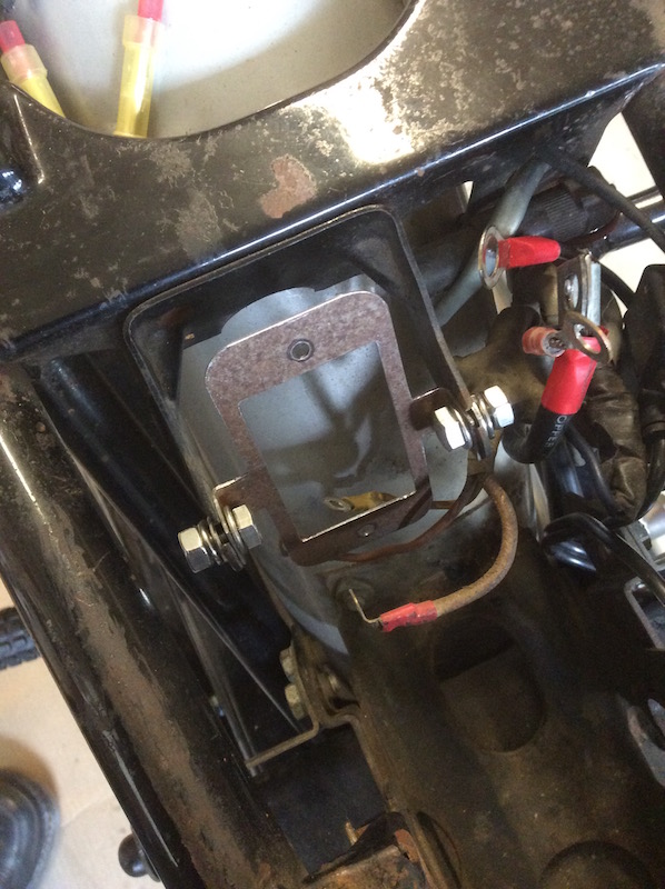

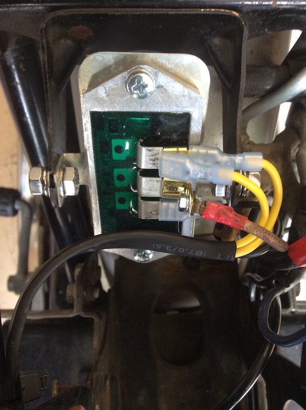

Fabricated and zinc plated a bracket and installed a Kohler rectifier/voltage regulator using the old rectifier location. I made a new wiring harness for it, shrink wrapped it and sealed up the old wiring connectors in case I or a future owner want to put the old rectifier back.
A Sachse electronic ignition is on the way. I should be installing it next week.

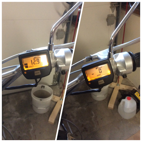

I had a old Kisan volt/amp meter lying around and decided to temporarily install it to keep an eye on the new R/R's performance. I'll remove it ASAP.
IMG_1436 2.JPG (41.85 KiB) Viewed 1806 times
