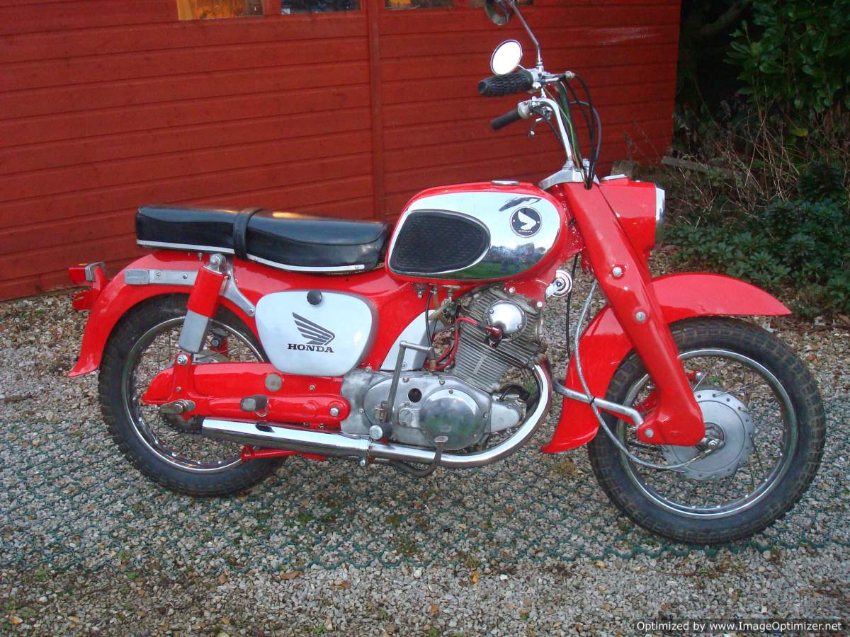

Post by G-Man » Sun Dec 21, 2014 3:09 pm
Well-recovered. :-)

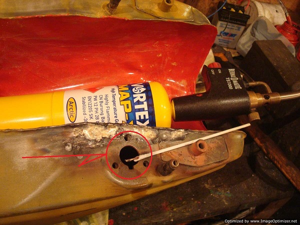

If you haven't already, the area around the petcock should be re-surfaced carefully, as the petcock gasket goes on the outside of the mounting holes.
petcock gasket placement1.jpg (55.82 KiB) Viewed 3793 times

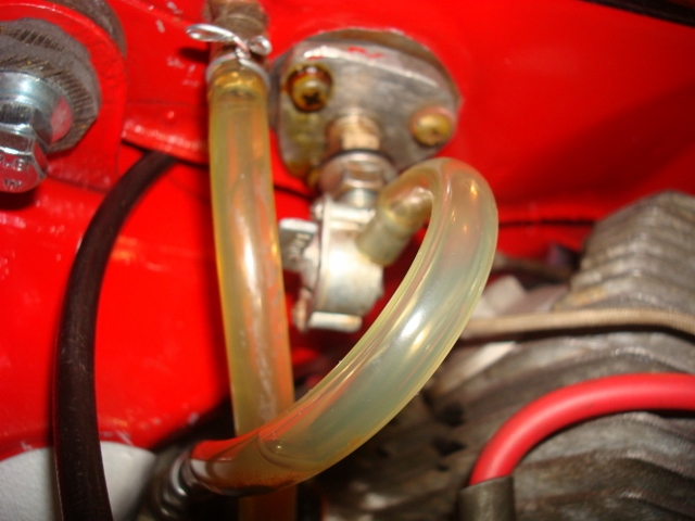

yes I cleaned the area around the petcock having said that the original petcock disintegrated when I removed it and tried to strip it down. The bowl just crumbled away. There is nothing left of it so I made my own replacement I found a piece of alloy about 3/8 inch thick, cut it into the triangle shape and drilled and tapped a hole in the centre and bought a new fuel tap off a pit bike cost about £5. I know im a skinflint.

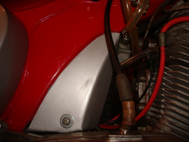

Made a pair of carb covers until some originals turn up.
