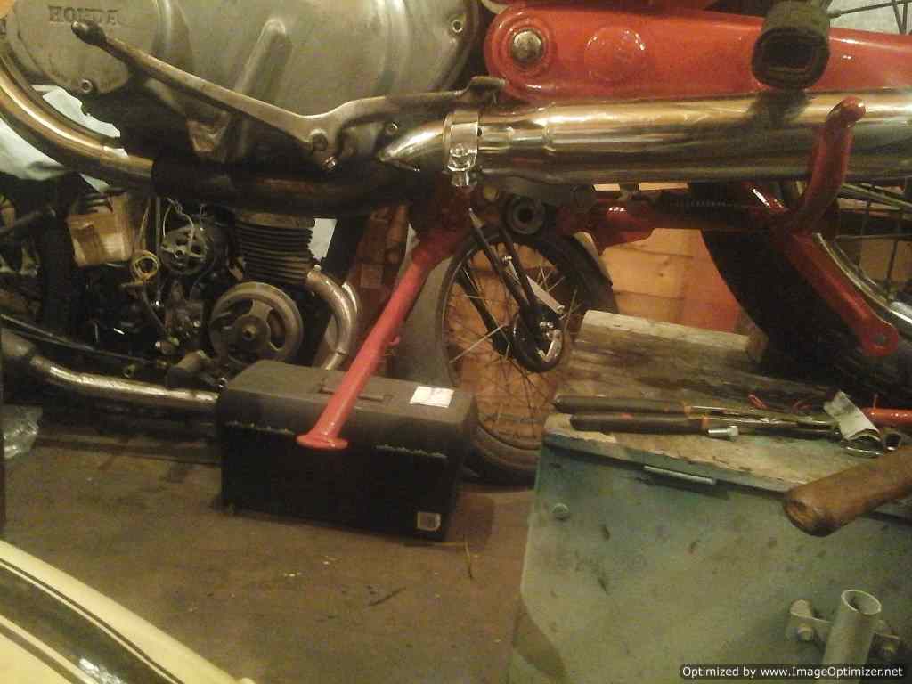

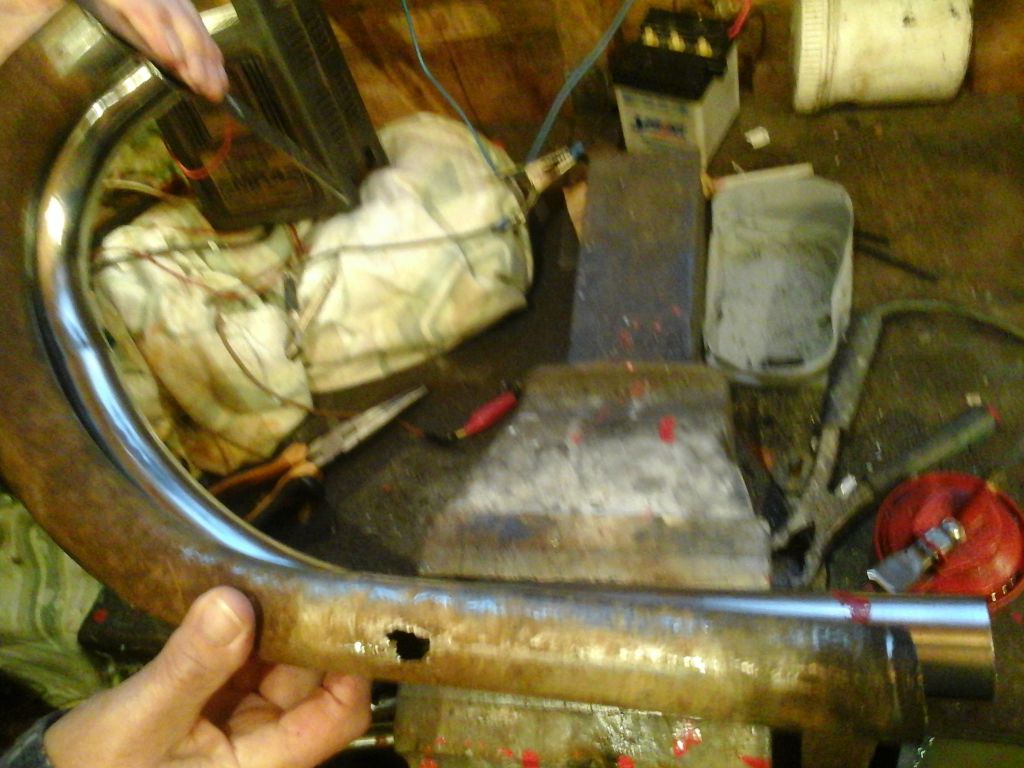

Post by pieeater » Fri Dec 19, 2014 9:15 am
photo of exhaust cut and welded ( what a mess )
photo of exhaust by the side of the old one

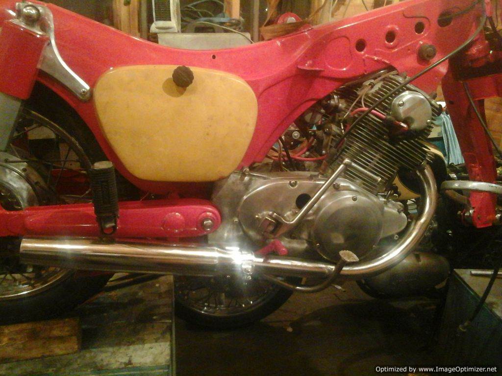

Post by pieeater » Fri Dec 19, 2014 12:18 pm
photo of right hand exhaust fitted and left hand side with a kicked up section so to match the right side.
