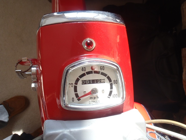

It's still too early to know for sure what I'm going to do with it. I bought it because I believed it was an original low mileage (pic) bike. Looking close, I can see that the engine swap was barely complete...loose bolts and wiring not connected. I doubt it ever ran after the swap...although someone did put gas in the tank and Carb. I've since drained it and cleaned the carb so it doesn't stink up the living room. Returning it to the correct configuration still appeals to me so, maybe with all of your help, I figure out what's wrong and plan to make it right.

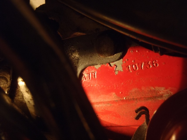

We're tearing the house apart in the spring to re-build...so for now, I'm pretending it's my man-cave. The Dream does make a nice decoration...even my wife likes it.48lesco wrote:Based on the list in G's first post, it looks like a '61 frame, probably titled in '62. Wiring harness will probably say 1961. I like the spirit of taking it back to original, and having it in your living room. I just came in from a 50-deg shop. Married?
I think I read the Honda list wrong. I took the title literally assuming the frame numbers were on the left and engine on the right. I see it now. Thanks! MGH
