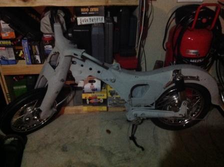

Today's progress
Post by primer63 » Sat Feb 01, 2014 9:43 pm
Thanks to some clarification from Bob750 (kudos in prior post) I have the front forks and cushion together now along with the front wheel assembly. My first milestone was to get it to roller status. DONE. Not perfect, just assembled so I know that I have all the parts (or not), and I don't have to keep putting up loose parts after the weekend. My workshop is also my garage which is full of vehicles that need to be out of the sometimes severe Texas weather.
Next step is to order missing parts.
I've been looking at this frame and wheels for almost two years, but I am still struck today by how small these bikes are, now that I have it to "roller" status.
