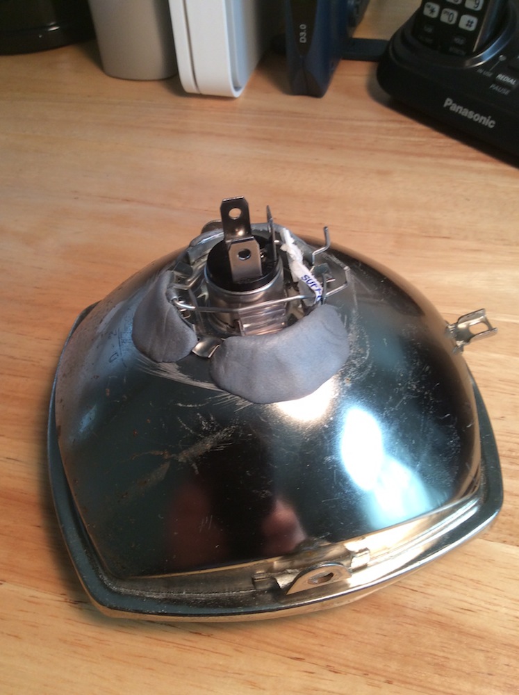

Post by Seadog » Fri Mar 20, 2015 9:25 am
I used a heat resistant version of JB Weld today to join the lamp base to the headlamp. Once it sets up, I'll file and shape the epoxy, then repaint the back of the lamp. I wish that I could have soldered it, but I couldn't find the flux and I didn't want to damage the reflective coating. Notice that I left gaps in the epoxy to accomodate the bulb and the wire bail that holds the bulb in place.

deafanddiabetic
Posts: 258
Location: Nebraska
Post by deafanddiabetic » Fri Mar 20, 2015 10:08 am
Great pictures, Seadog.
Mine was not nearly as pretty, but that's basically the process that I did.
I cut out the bulb, desoldered the base, found a cheap cheap cheap bulb holder at Advance Auto Parts, soldered it into the hole in the headlight bucket and now I can swap H4 bulbs out like it's nobody's business. Took all of an hour and total cost about $7. It's pretty messy back there though, haha.

Post by Seadog » Fri Mar 20, 2015 12:09 pm
deafanddiabetic wrote:Great pictures, Seadog.
Thanks. Wish that I could have found the bulb holder locally (and cheaply). If the epoxy that I used doesn't hold, I'm going to try soldering. When you soldered yours, did you have any trouble with the reflective coating inside the headlight? Use an iron? What did you use for flux?
deafanddiabetic
Posts: 258
Location: Nebraska
Post by deafanddiabetic » Fri Mar 20, 2015 3:37 pm
No problem with the reflective coating, I think mostly because the soldering was all applied to the back of the contoured casing. I'm pretty sure I used Rosin Core 60/40. It's held on, taken the heat, and seems like it's working alright. It was pretty shoddy and quick, honestly totally on the fly one afternoon in the dungeon and now I see that others have tried the same method with success.
