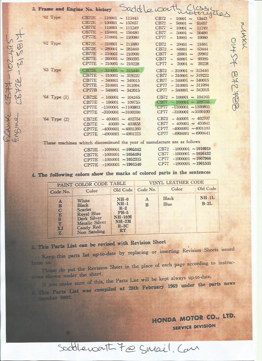

Dating Cert
Post by lloydy1 » Fri May 05, 2017 7:10 am
Does anyone know which book this dating sheet comes from please?
I am trying to get a dating cert, but the guy who is doing it for me is struggling to fined the reference book he can refer to to issue cert.
Thanks Dave
Scan 1.jpg (162.11 KiB) Viewed 28500 times
DJM
Posts: 553
Location: Chesterfield UK
Post by DJM » Fri May 05, 2017 10:00 am
It's a page from the official Honda Parts book for the model, late version dated 1969.
The same information is in the earlier versions too.
Useful data as it explains how three different series of numbers from three different years all start with the figure '1' This has confused more than a few into thinking they have an early bike when in fact they haven't!
