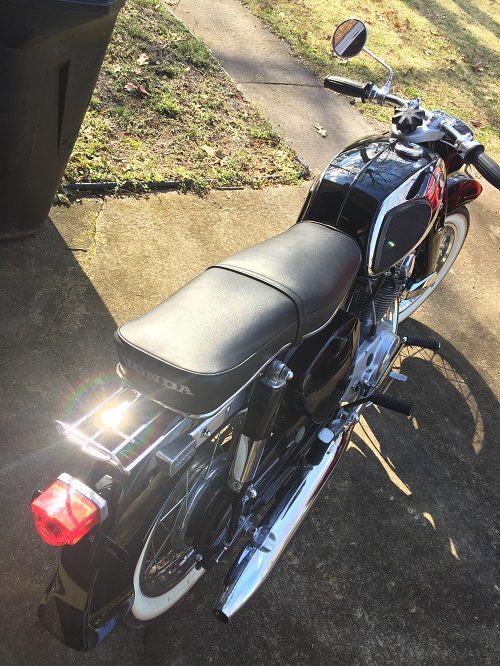

Post by Gaius M » Fri Mar 17, 2017 8:50 pm

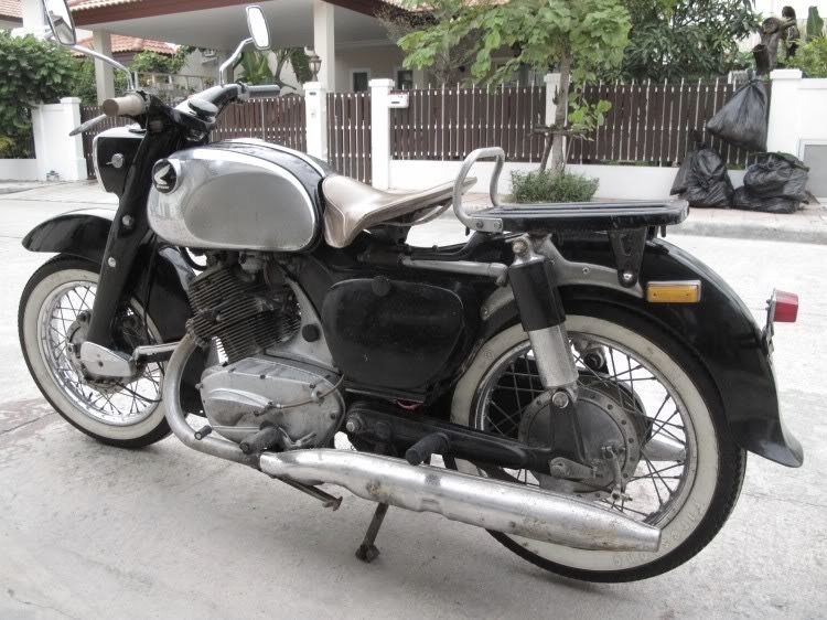

this is identical to the originail benley rack, the only difference is the mounts were changed for the size of bike it went on.
G-GAURD
Posts: 67
Joined: Tue Jul 06, 2010 1:37 pm
Location: highland,ca.
Post by G-GAURD » Sat Mar 18, 2017 7:44 am
What kind of bike did it originally fit ?

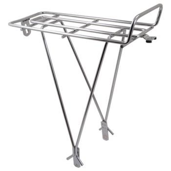

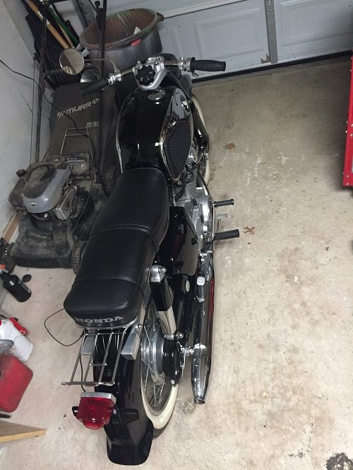

Here is another option in the form of the Wald Bicycle Rack.

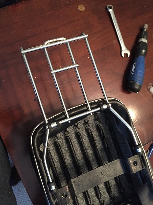

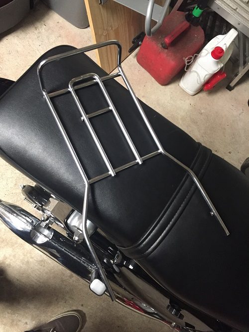

The Wald rack used to be a favorite of mine back in my bicycle building days. I used to cut them up and butcher them for different purposes. But just last weekend I decided to break out the angle grinder and see if I could mod up one of these Wald's for the Dream.
THe plan is to use P-clips to mount the rack to the bottom of the seat frame.
I'll post updated pics once I get it all worked out.

This was what came with my 1962 C72.....
Perhaps a bit large but I've had it re-chromed fro putting back on the bike when finished.

Post by stepper » Sun Mar 19, 2017 3:40 pm

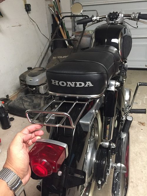

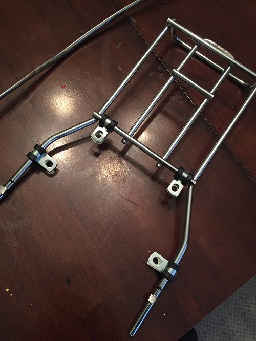

After posting yesterday I was inspired to finish this project.
The P-clips were easy to find at my local Lowes and everything turned out surprisingly well!
The trim rail needs to be removed and the seat cover peeled back a bit to gain access to the seat frame but everything else is pretty straight forward.
If I were to do it again I would probably go for longer screws as it was a bit of a pain to get the nuts to catch a thread while attaching.
