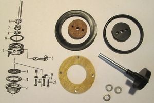

Just to understand fully - when you say leaking, do you mean that there is still fuel running out the fuel hose into the carby (ie the petcock is not closing properly) or is the fuel leaking from around the bowl?
There are a few examples on this forum of having the gasket up the wrong way and fuel flowing when the petcock is off.
As Mike69 said, they are tricky to work with. Previously, my cork gasket had swollen up so much that it restricted (stopped) fuel flow into the carbie. I had to run a drill bit up thru it to get it to flow correctly. The rubber bowl gasket on mine often tends to swell and distort quite badly as well. Last time I had it off, I had to reinsert it very carefully and nip the bowl up quite firmly to stop it leaking. Just a trip - I use some form of never-seize on the fine aluminium thread of the bowl in an attempt to avoid damage and seizing.

G'day Robbie63
Thanks, that helps diagnose the problem a little further. Others more experienced here will correct me if I'm wrong, but from you describe the problem is unlikely to be the small cork gasket (or alternative rubber gasket) with 3 holes in it (part no 8 below). I understood this just seals the fuel flow between off, on and reserve. If this was leaking, I think you'd see fuel leaking as you describe all the time or from around the position selector lever.
I'm betting there is a problem with the seal between the petcock bowl and petcock body (part no 10 below). If the petcock is shutting off properly (as it appears to be), this seal will only leak down to that level and then stop, as you describe.
Here's a suggestion.
- Leave the tank on the bike if it is still there
- Turn off the petcock
- Put some rags on the bike under the petcock bowl
- Remove the bowl, seal and filter sieve
- Confirm that the petcock is fully shutting off the fuel flow - this will confirm if there is a problem in this area
- Inspect the flat top of the bowl to ensure it is not damaged or corroded - any damage here will make it difficult for the seal
- Inspect the bowl thread and corresponding internal petcock thread - make sure it is all clean and damage-free
- Put a little never-seize on the petcock bowl thread - spread it right around the thread
- Screw the bowl onto the petcock without the seal and sieve
- Make sure the thread screws up fully - from memory it should screw up all the way until the bowl touches the petcock body - do not over tighten, just make sure the thread is good all the way
- Unscrew the bowl
- Inspect the rubber seal and sieve for damage
- Inset the rubber seal and sieve and screw on the bowl slowly and carefully until it seats on the seal
- Nip it up reasonably firmly with the correct sized ring spanner or socket - don't damage that aluminium nut
- Turn on the fuel and tighten the bowl until it stops leaking, but don't over-tighten and damage the bowl threads or nut.
When I last did mine, I know I had to tighten pretty tight on the last step above, but it did stop leaking. The never-seize should protect the threads and make disassembly easier in the future.
I hope this helps your dilemma, as they are shifty little suckers!

Thanks Muddy from Down under,you were right unscrewed the bowl and thwseal,no 10 was pinched,so I put original seal back on,it fit better I think.Put it back on and that fixed it.thanks again to everyone's input.ps another great forum.i was on the fourwheelforum,while restoring my 63 150 and they were great as well.took it for about a twenty mile ride today and works great.not sure how fast I was going still waiting for a speedo cable.thanks again rob
