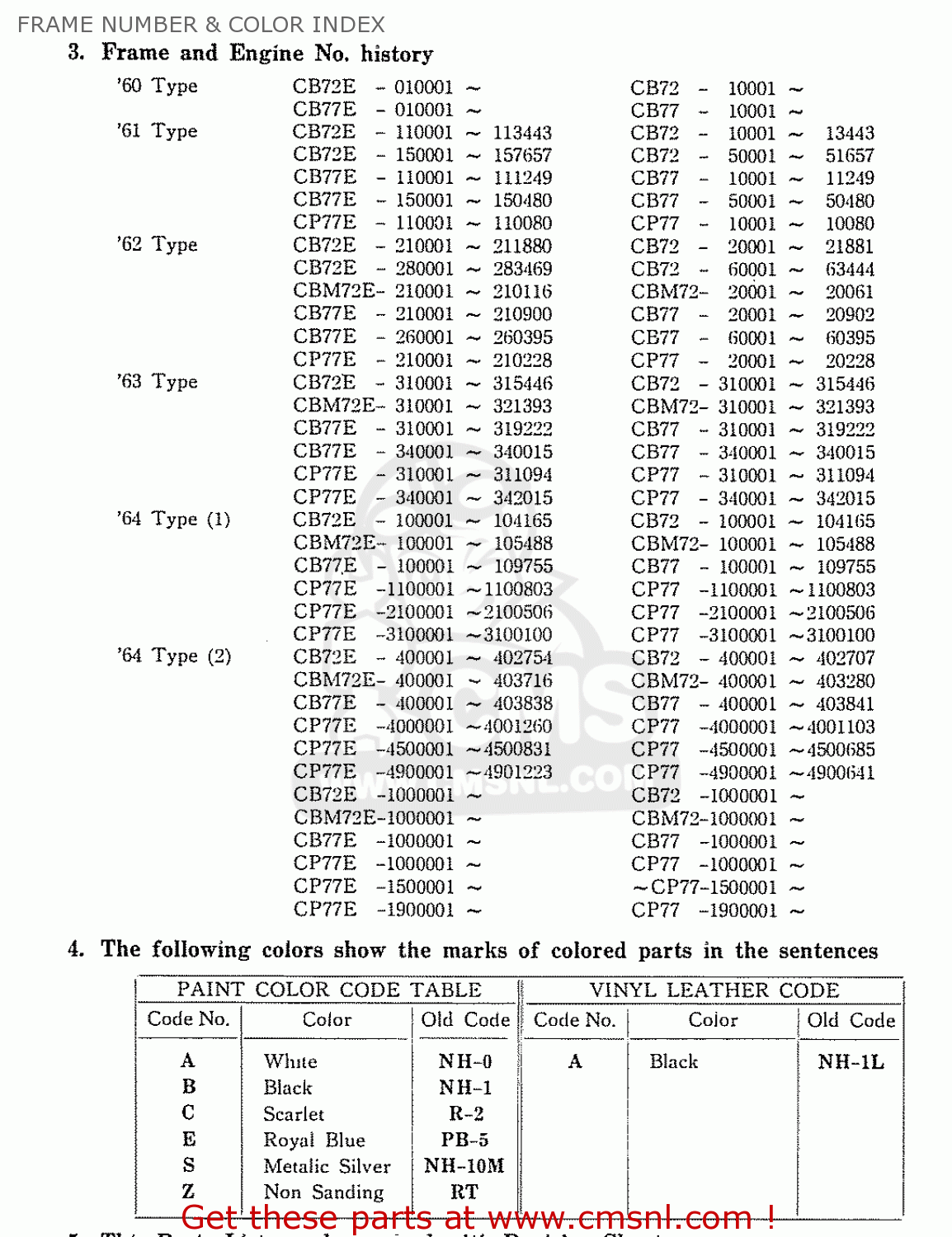

Is there a data sheet showing the serial number range for the Superhawk for each year produced, as well as how many were produced for each year? I recently acquired two, one I want to restore to original, and the other perhaps a cafe style. Thanks.
Hi Dick
This is the front page out of the CB72/77 parts manual. Some people have bikes with numbers outside the ranges shown so accuracy is not perfect. It's a start, though....

It should represent the last engine or frame number that was produced that year. Sometimes it falls short.....
WrenchRust wrote:Any idea what Honda means by "These Machines whitch discontinued the year of manufacture are as follows" ?
