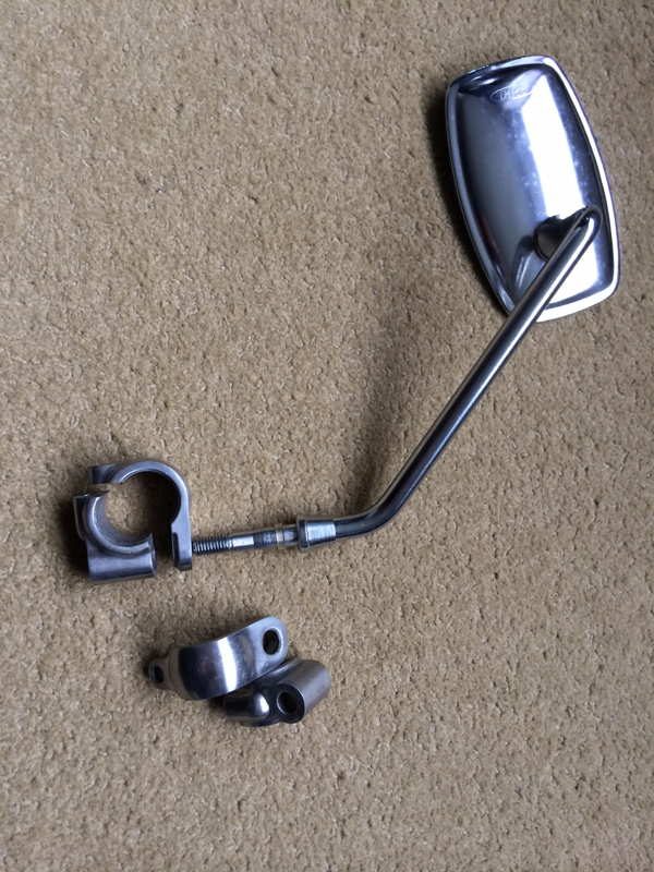

The clamps that are holding those mirrors are the clamps/mount system for your Buco windshield. The clamps you need are a two piece unit, parts 88131-257-810 and 88132-257-810. The mirrors are 88110-257-810 and 88120-257-810. I believe I have either the right or left mirror NOS.

That is a beautiful looking bike. The mirrors and brackets are pretty expensive if you can find them. I'm not convinced that Honda fitted them to all the early bikes.

thanks for the info so far, I was wondering on the mufflers as well. I have a cb160 with excellent perches that I can swap out with mine since they have the holes for the mirrors. I am going to sell the windscreen anyways so I can sell it with the mounts I have, I personally don't care for the look of the screen when its on the bike.
