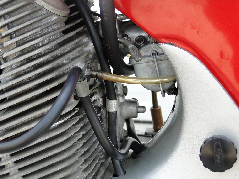

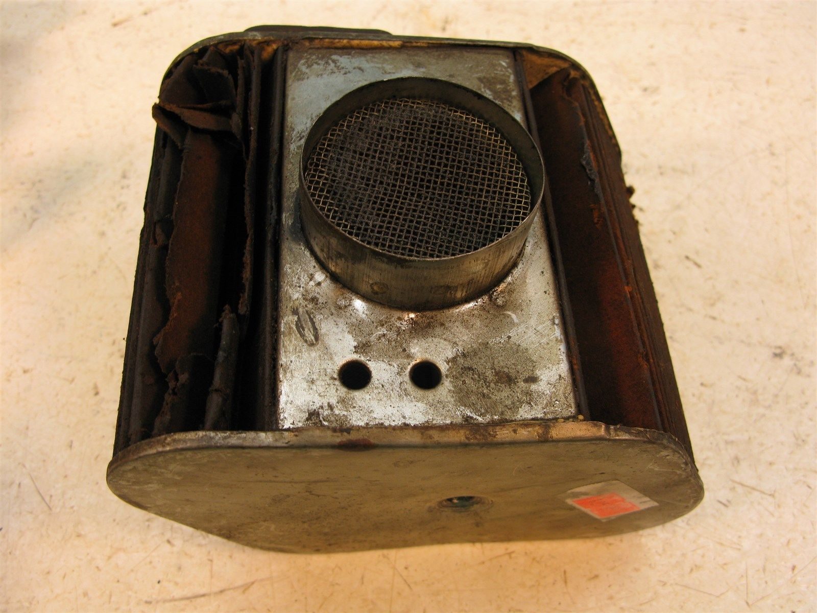

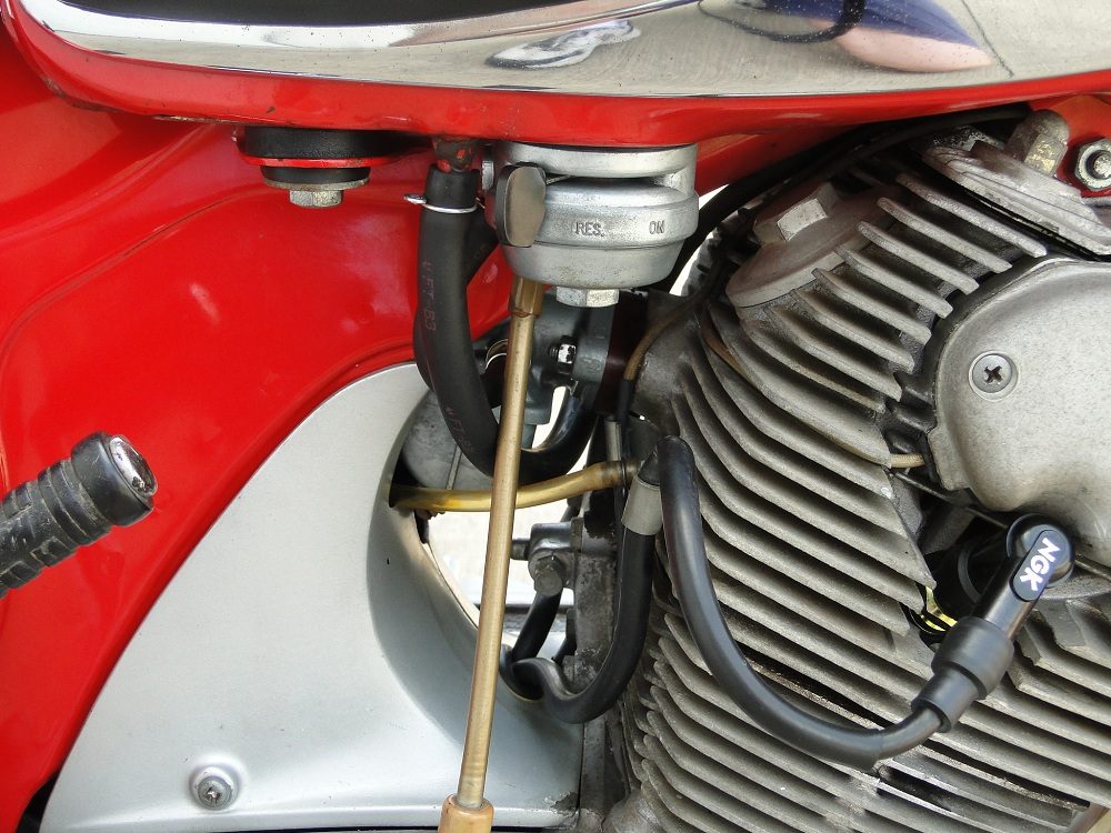

Post by 48lesco » Sun Aug 31, 2014 10:00 am
Here's a couple of snaps. The other ends of the tubes go into the holes in the air filter. The tubing has to have the right ID and OD to fit properly at both ends. No shame in simply capping the nipples off. As mentioned previously, Honda eliminated this feature in later years.

Post by nevernotbusy » Sun Aug 31, 2014 1:26 pm
Interesting! What a funny set up. I'm missing my air filter, so I had no idea.
