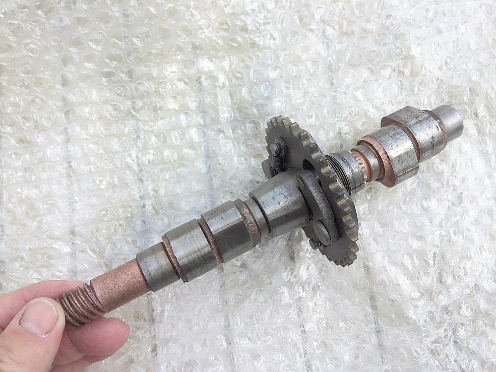

CB72/77 has tacho drive on left hand end.
CA72/77 sprocket has longer bob-weights
CA72/77 when assembled will have corresponding cam lobes (left-right) at 180 degrees
CB / CL when assembled will have corresponding cam lobes (left-right) at 90 or 270 degrees

The bob weights are they the arms on the mechanical advance?
the tacho drive side makes a good point of reference. I will have to lay everything out on the bench and match items up and use the verniers for cam lob size I guess . Assuming dream and CB will be different? Different grind perhaps.
Was concerned that halves could be inserted in more than one orientation.

Yes the weights are the spring loaded arms. The dream ones extend further than the CB and CL ones. The dream lobes will be different with less lift if I remember correctly. I think CB and CL lobes are pretty similar. Each half has a missing spline which lines up with the sprocket so they can only be fitted in one orientation.
