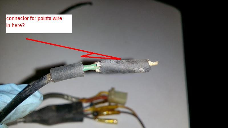

See if you can pull the white stub (points wire)out of the rubber connector

brewsky wrote:See if you can pull the white stub (points wire)out of the rubber connector
Thanks Brewsky! I didn't realize there was a connection under the black cover. Is there a proper way to disconnect these connectors? Everytime I unplug one, I get nervous that the wire will pull free of the connector.

Yes the wires can pull out of some of those stubborn connectors. I sometimes gently heat the plastic covering over the connector to make it pliable again and use a small needle nose pliers to grasp the actual connector rather than pull on the wire.
