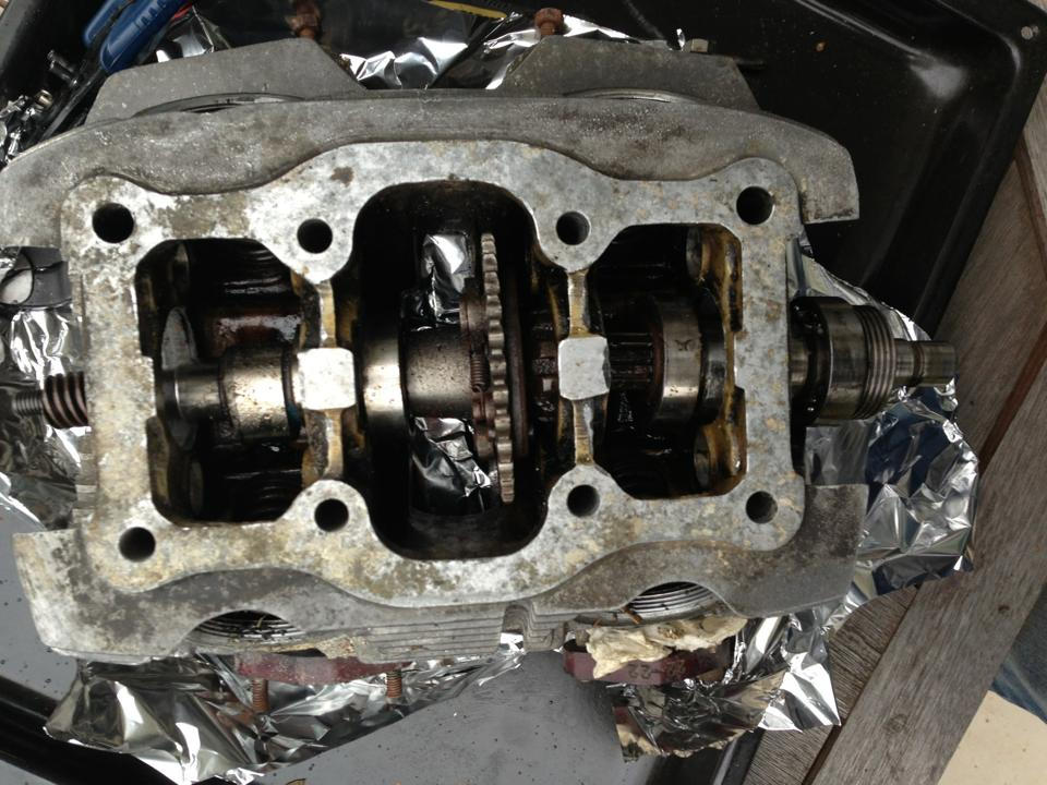

Post by DrMowl » Tue Sep 17, 2013 12:15 pm
Hey ,
i was able to disassemble the cylinder head and to knock out the outer bearings (like the manual says).
Any ideas how to get the others out? is there a trick? unfortunately the head is a bit damaged due to the hard knocking. But nothing too bad.

Post by ahenthus » Fri Sep 20, 2013 9:57 am
What do you mean by the head being damaged from hard knocking? Your picture looks like the camshaft is bent or broken. Is it? Or is it a wide angle shot that just appears bent? The right side cam is at an angle compared to the left.

Post by Mike Mullins » Fri Sep 20, 2013 10:06 am
Do you have a manual ? the camshaft will separate into two halves and then each half can be removed from each side. The cam sprocket will separate from the right half and comes out the top. I cant remember the exact procedure (its been a long time since I did it) but the manual will outline the procedure. Good luck

Post by DrMowl » Fri Sep 20, 2013 2:57 pm
yes i do have a manual, but in my opinion it's explained rather bad :/
ahenthus wrote:What do you mean by the head being damaged from hard knocking? Your picture looks like the camshaft is bent or broken. Is it? Or is it a wide angle shot that just appears bent? The right side cam is at an angle compared to the left.
it isnt bent neither is it broken. I managed to knock the bearings out on the right side and the bearings on the left moved with it. right camshaft is loose, the other one still connected to the left camshaft. how do i remove it wothout damaging anything?
