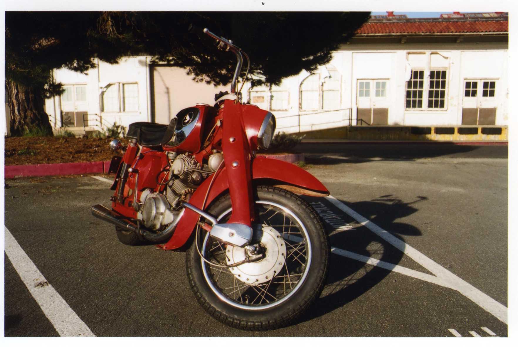

Btw, here's my Dream.
I'm new-ish. Been tinkering a bit. I've won a few battles.
