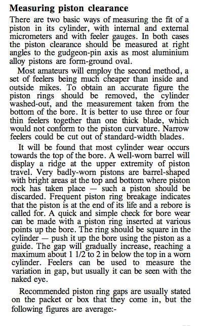

A piston is tapered and oval. The largest diameter is at 90 degrees to the gudgeon pin at the bottom of the skirt. You can use this part to gauge the wear in the bore. The clearance between the top of the piston and bore is not a good measure as this is the smallest part of the piston. The rings take up the clearance.
Biggest wear will be at the top of the bore (front and back) just below the top of the liner where the rings reach up to.
So to detect wear you can compare the dimension at the top of the liner in two planes. This will hampered by a ring of carbon just above where the rings travel to.
It looks like your cylinders are standard at 60mm. Digital calipers are not the most accurate tool but are handy for getting the nominal size.
See exerpt below for a simple technique below.
