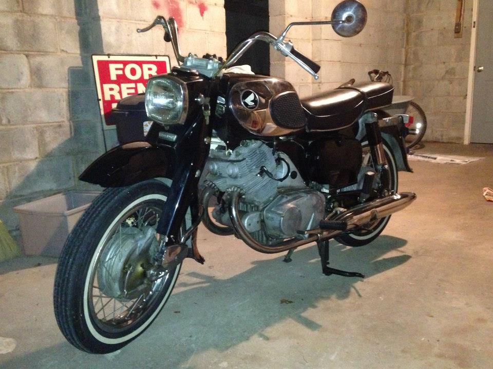

Will any 12V 9A battery do?
Thanks!
No, size and shape is an issue, as well as which side the ground is located. That being said, there are plenty of bikes out there with the wiring redone to accommodate the swapped polarity. I actually went with a smaller (size and amp hour) AGM battery which works fine. It's a YTX7L. Stock ground may not fit directly, I just made a metal adapter for both posts and insulated the area to be safe.Will any 12V 9A battery do?
