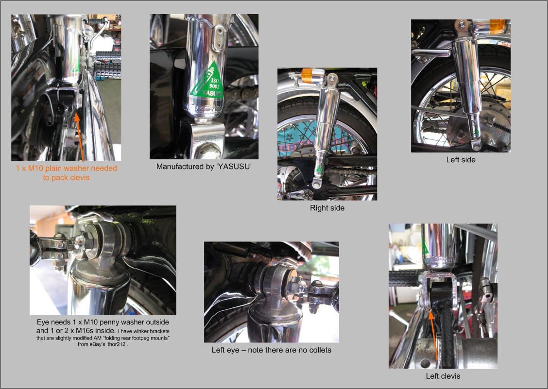

Phil, yes, they are. I think I got them for US$50 plus shipping, back in '08. I've not pulled them apart (yet) but I'll be happy to attempt what you're suggesting; I still have my OEMs in the garage. I bought them as CB failed the inspection on dodgy front wheel bearings and a bouncy arse end, so I figured I had little to lose at that price. Got the new, sealed wheel bearings for €15 the pair from a local bearing & seal (not the aquatic or singing variety) supplier.
They ride fine, AFAICT. I never carry a pillion, but I weigh-in at 92kg / 200lbs and I do run them on the hardest setting. Majorcan roads are notoriously unflat and probably almost as crap as the UK's roads are after last winter there. No idea how that sort of surface compares to those in the States, though.
I'll see if I can find who I got them from and you can bid him in the nuts.

They've got to be better than the clapped out stockers on my bike! Yeah let me know if the stock covers will fit.

Phil, I de-constructed my OEMs yesterday. The top cover -- mine have the plastic type -- is about 40mm longer than the chrome one on the AM shocks.
I've not attempted to disassemble the AMs as yet, but there are no collets visible. Perhaps there's some kind of concealed retainer that gets revealed once the top cover is compressed away from the upper eye; we'll see, in due course.
There are shocks on eBay, right now, with black, blue or red top covers as well as the all-chrome type. Worth a look? Even if the coloured ones aren't the right shade they could be prepped and overpainted, I'm sure. Food for thought?
