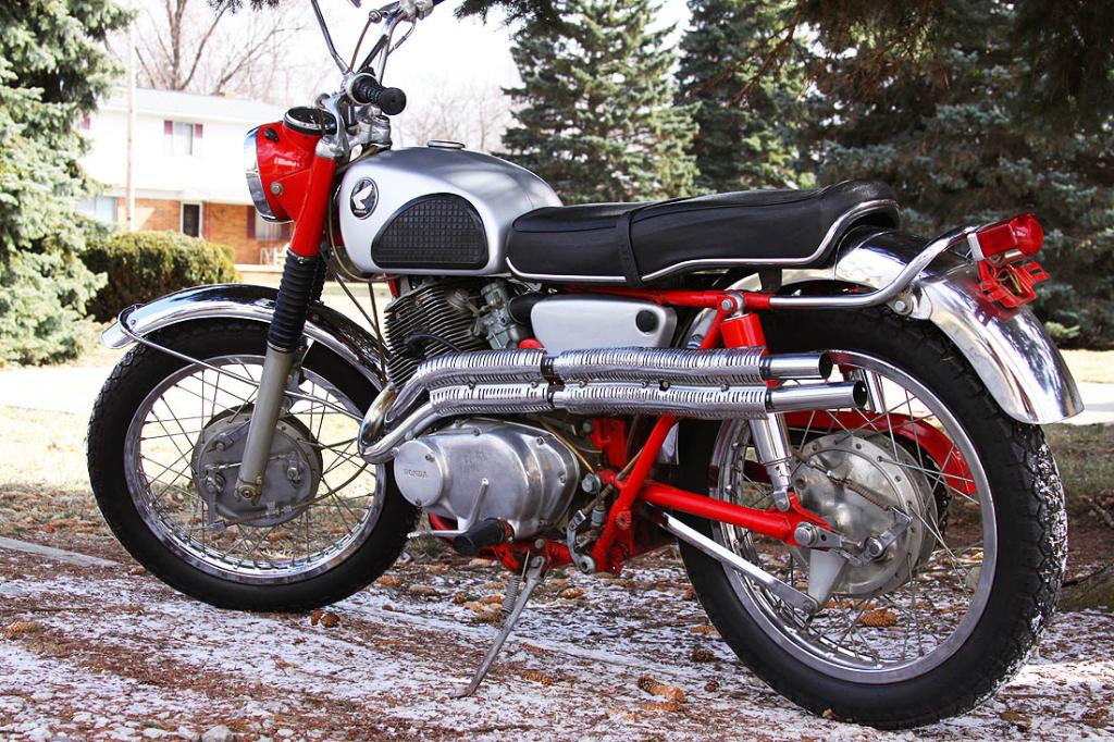

Not my bike but you get the idea......

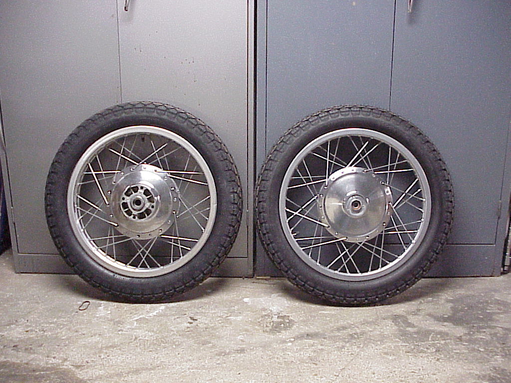

Never got around to putting the wheels on the bike. Had to replate the sproket nuts and bolts. But I did promise pics of the tires on the wheels. So here you go. You can just notice the added curl to the sidewall near the rim on the 3.25 mounted to that WM1 front rim.

Dunlpp K70 3.25-19 on right and 3.50-19 on left.
