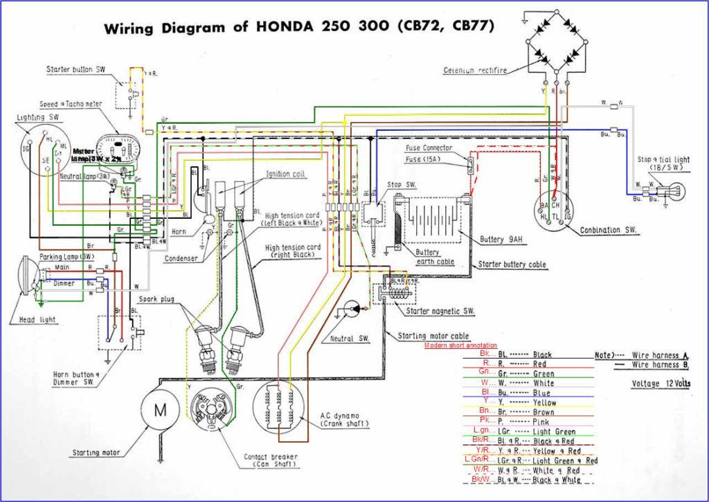

I have the old 250cc shop manual but darn I cant seem to find a wiring diagram in there? Did get one on here but I need to either enlarge it or be able to print it out in color in order to read it properly.

Herewith attached again.Larrygry wrote:I have the old 250cc shop manual but darn I cant seem to find a wiring diagram in there? Did get one on here but I need to either enlarge it or be able to print it out in color in order to read it properly.
Black is +12V ignition, green is ground but yellow carries AC from the alternator/dynamo/generator (whichever you prefer to call it) to the rectifier and tees-off to the light switch for coupling to the pink when the headlight is selected (for additional charge support). It could be a winker relay or some kind of retro-fitted voltage regulator (unnecessary). Can you post a decent image here?Larrygry wrote:SO I attempt to follow the wiring and I end up finding what appears to be an electrical device that is not listed in the either shop manual or what I can read/see on the wiring diagram. The device is a small silver colored cube 1" x 1" x 2" and it is (was) strapped to a frame post in front of the battery. It says on it:
