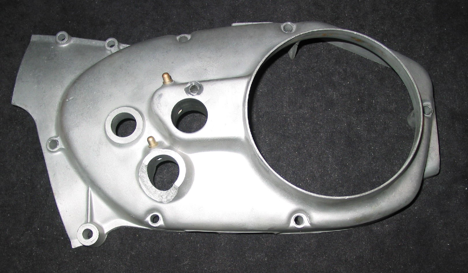

A little Mothers Aluminum polish can work wonders on those covers. If they're rough a little sanding will make em like a mirror. A bit arduous, but wonderful results for a simple task. I can give you a step by step if you aren't familiar with sanding aluminum.

i had trouble getting the clutch to disengage before i tried to ride it. LM and i chased it down to the right side cover. i hadnt installed any of the kick start related parts back on the cover after bead blasting (only installed the clutch adjuster). fixed that problem by using a different cover with the kick start pinion gear/spring still on it. i just blasted and painted a rotor cover for now instead of polishing it.

i wanted to replate everything, but i dont have access to a chrome tank. i know all i really accomplished by polishing the chrome bits was temporary rust removal and exposed more steel to the environment. anything aluminum was bead blasted, most were polished with white diamond.
