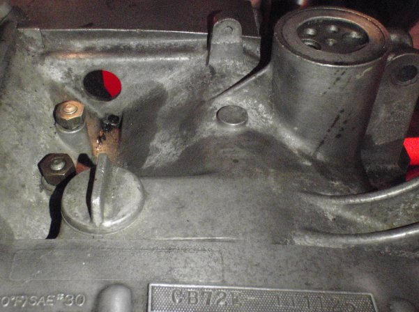

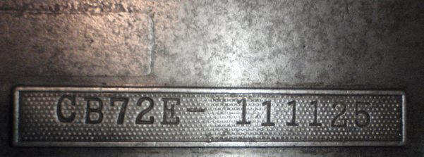

(seven digits for the engine numbers and six digits for the frame numbers, I putted in some pictures of this engine, including a view of the breather. This is different than a 1961 CB72 engine case which has six digits, see picture, and notice the strange reworked engine breather)

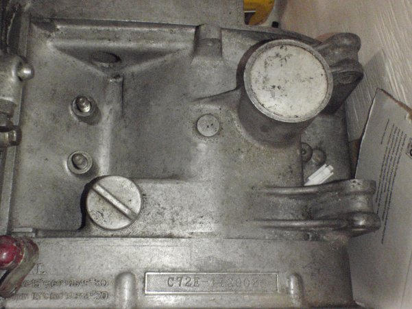

1962 :
engine numbers : from C72E 2100001 to C72E 2107263
frame numbers : from C72 260001 to C72 262238
(also seven digits for the engine numbers and six digits for the frame numbers, see the picture of the engine case number, the last digit is a zero, a bit difficult to see)
This is unlike the C77 engines, witch had the standard six digit numbers (see image of this 1962 C77E engine case. The numbering of the C77's where more according to the standard (cb72 / CB77 numbering)
That means you have a 1962 engine, everything with C72E is called domestic by the Americans, because in the US the engine numbers start with CA72E...... The A stands for American, these engines do have some different gears to make it more comfortable at the speeds in the US.
When you take a close look to the numbers, you will see that there are more engine cases made then frames.

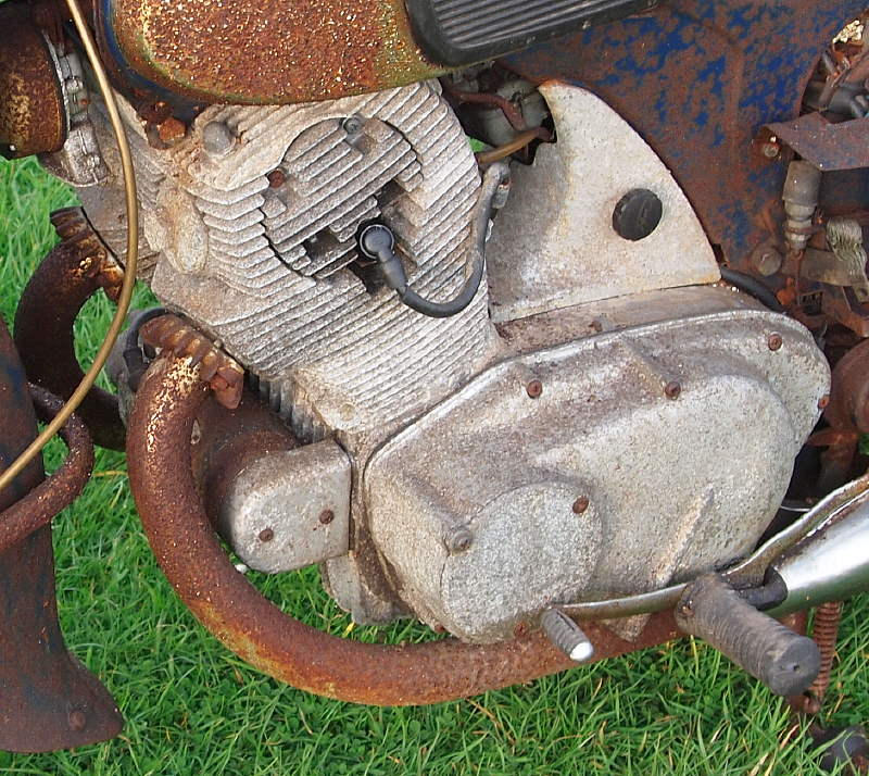

The head cover is clean, with no marks on it like type 1 or 2 engine, the top engine doesn't have a breather tube, the left crankcase cover has the small oil filter cap and the crank bearing diameters are comparable with the later engines. Some bolts are JIS, be careful with them, as the are quite difficult to get. There are over 12 different left crankcase covers for these type of engines, could you post a picture of this cover, especially the way the oil pipe (outside of the cover) is shaped ?

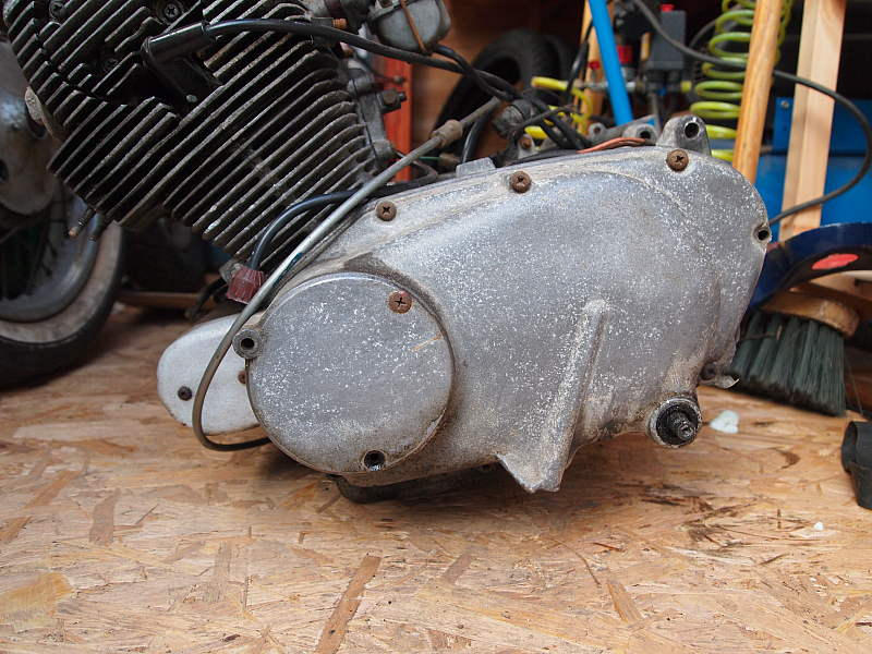

The engine cover picture is from my spare engine. The complete bike is currently in storage away from home. I have attempted to do a close up of the cover from the pictures I have....

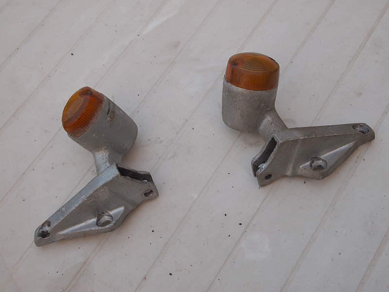

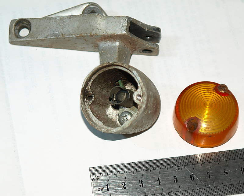

Very, very interesting winkers. If you want to part from it....
Really, I have never seen these types but I knew they where existing in the country's I mentioned in my earlier post. The best thing is that you have a complete pair, and these winkers are in good shape. Are this Stanley winker glasses ?, or is it another brand ?

Unfortunately one of the glasses is broken and only 1/2 is present so the pair is not complete. I would be happy to swap them for other C72 parts but you would have to get one replacement glass.
Not sure if there is a name on the glasses but they look just like the ones on the CMSNL C72 online parts manual. I have the rear ones too, but no glasses for them.

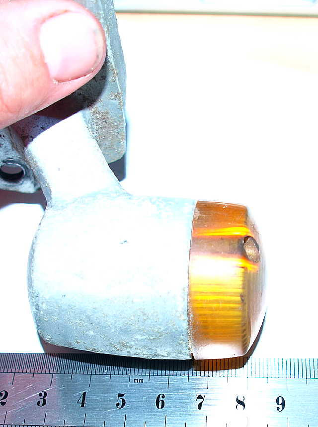

If those are Stanley, I might have a suitable glass for you, can you make a close-up picture of the glass (top view and side view) ?

I searched in my part manuals, and looked at the CMSNL-site, but I can't find an exact picture or drawing of the front winkers. There is,. however, a sort of picture, but that are not the winkers you showed us. Can you point out to me where you found a picture of the front winkers ?

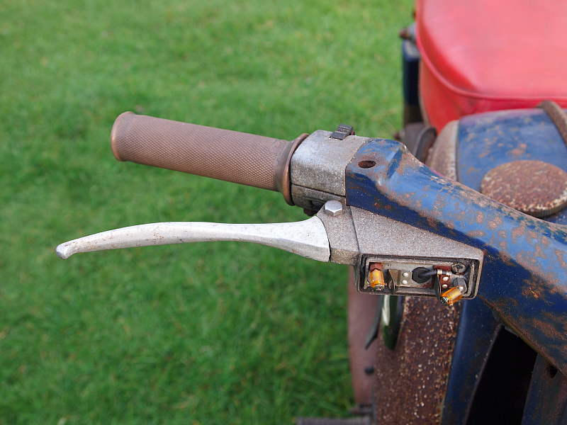

No sign of Stanley on the lens. Pictures are below, as requested. I have checked the CMS site again and you are right. The ones in the parts manual are not the same but are similar. The manual does not show the lever bracket incorporated.
