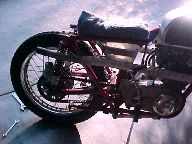

Scram, I've been making some progress on the flat/street tracker. Engine is done, runs great, with a 3mm overbore, very tourqey. I made a right side pipe, but took a different route than most. I didn't want the sharp bend of the left cylinder pipe pipe, so they are now both right cyl pipes, and crossover. I using an early CL72 swingarm, and single leading shoe brake and hub, that will eventually be laced to a nice flanged aliminum rim. Front end is from an SL350, as is the front wheel, which shall also receive a flnaged aluminum rim when funds allow. I made the bracket for the SL speedo, mounted Pro taper bars with an adaptor kit, and made aluminum sidecovers. I will purchase an XR750 seat and fender kit for her soon. I rode it yesterday, just up the street, with a towel for a seat! Currently running straight pipes, waiting on some baffles. I'm still in mock up, and have more frame mods, and many other changes to make before I tear it all back apart, and start finish work. Here's some pics of her so far, hope you enjoy them.

Davomoto, I love your work and follow it when ever possible. Sounds like you've got a great start.
I also have a custom in the works. It's a very low mileage electric start, CA motor in a CL frame with an early swing arm. I won a pair of Koni shocks off Ebay that only need bolt collars. I welded a top engine hanger to the coil area (coil under seat) and I cut out the cradle tubes. All tabs and battery box are removed. I have a CB200 tank mounted and a flat track seat. The front end will be stock steel CL, low superbike bars and my custom disc brake hub with aluminum rim. The rear is a small hub with a 2.50 aluminum rim. I am doing the wire harness now. I am planning twin down exhaust, 2 into 1 with a centered supertrapp under the motor. I'll keep you posted when things progress. I need to get a picture posted also. Scram64

Post by davomoto » Mon Nov 02, 2009 4:24 pm
Steve, I've got frames with no matching engines, engines with no matching frames, boxes of hubs, and parts o plenty. Rather than send them to the scrap man, I like to build an occasional custom. It is much more involved than a resto, in my opinion. The " correct " parts aren't just bolted on, everything is fabricated, thought out, mounted, refabricated, re-thought out etc. I typically shed 70+ pounds of weight off of a 305, and there is no better way to increase pefrormance, handling, and even braking. Now, I know the purists cringe at the sight of our customs, but how many people left them stock back in the day? I may have to do a chopper, and really piss some people off! Just kidding about the chopper! Here's s pic of what I did with a rashed and worthless oil filter cover.
