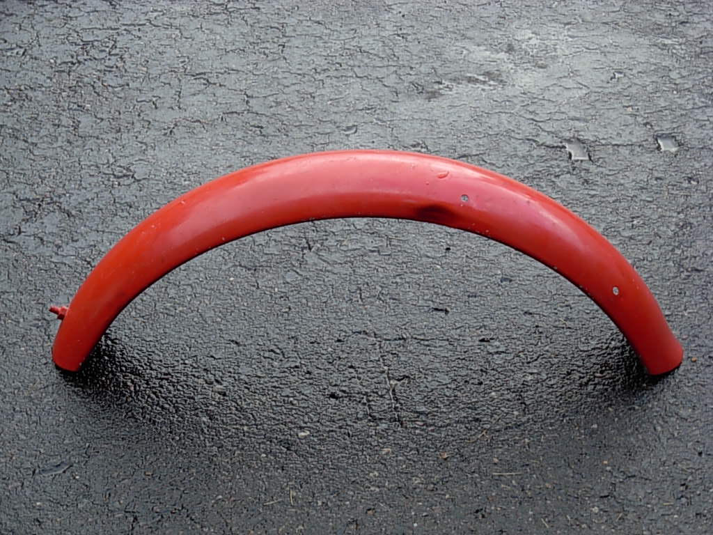

The original front fender (red, repainted from silver) that I have is missing the stay. The fender is steel, has a threaded mount on one side, 4 mounting holes, notches for the front forks and one flared end.
Is this fender typical of early CL77's? Does anyone know what the stay looks like? And finally, is there a part number for this type of stay? Thanks everyone, this site has been a great help!

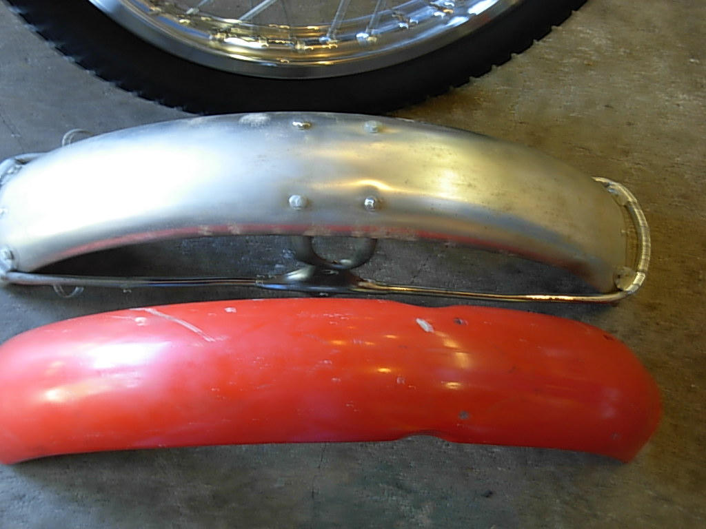

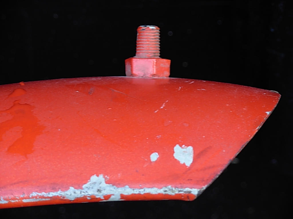

As promised here are photos of the fender I have...

That red one looks like a Triumph fender. Looks a bit like the one on my '68 Daytona. The stud attaches to the rear mounting bracket which doubles as a front wheel stand. You undo the nut and the rear stay swings down to support the wheel for wheel changeouts etc.
