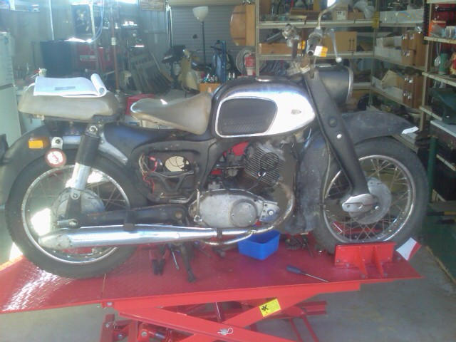

I have almost finished my restoration of my C92 so I thought I would post up the progression shots.
It has taken me about 6 months, so far.
I bought it from a small country town about 4 hours drive from where I live (it was a long day). It belonged to a fellow who's passion was more early british bikes, but he sadly passed away and his wife was willing to part with this bike.

The first thing I did was make sure that everything worked. It needed a new coil and the fuel tap was, well melted all on the inside.
Apart from that it seemed in pretty good shape. The engine ran without any noises and it did not leak at all.
There seemed to be an intermittant electrical problem that could be solved by giggling all the wires where ther air filter was, and the starter button was broken on the inside.
