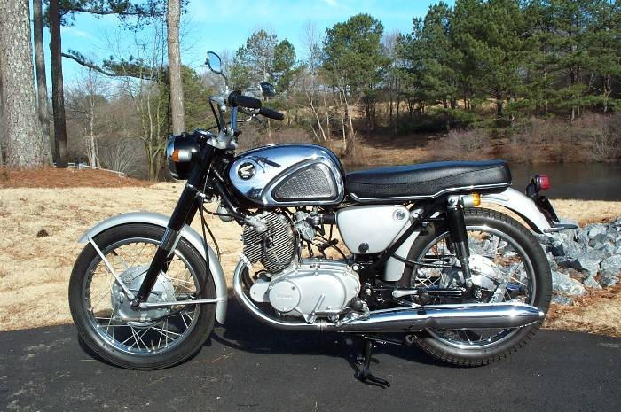

The flat 'bar is correct for the '66 CB77, up to frame nº CB77-1004688. At 1004689 the 'bar was changed to what is described as 'high western style'. Now, you can interpret that description as you wish. Two types of raised 'bar: intermediate and western (I guess); see pics.

Post by LOUD MOUSE » Sat Sep 06, 2008 8:50 am
The second pic. is the norm for USA issued Super Hawks.
Nice pics. What. ............lm

Post by e3steve » Sat Sep 06, 2008 10:18 am
Yeah, Ed. Both quite lovely bikes there. Shame the '67 has the thin-wall header pipes; the blueing kind of lets it down.
Is it my imagination, or does that CP have a '61 taillight?

And, Ed, I just learned that some CPs had the earlier taillight for a while after it was discontimued on the CB in early '62.
