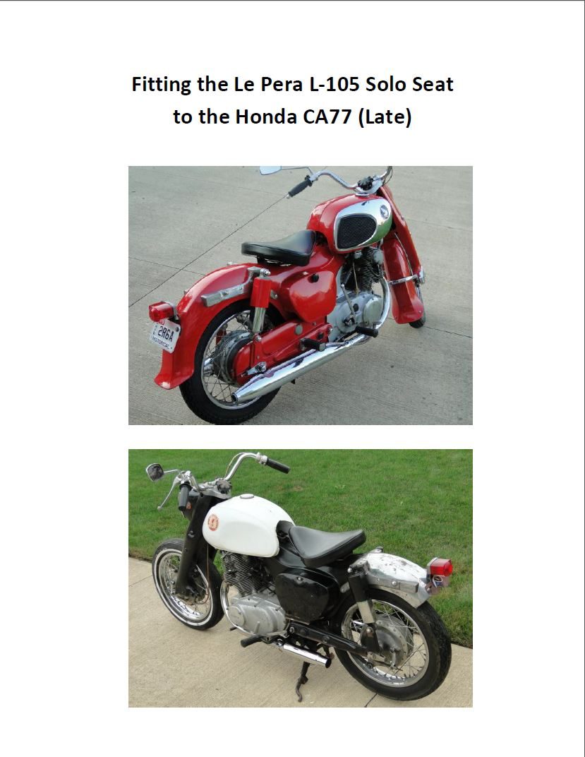

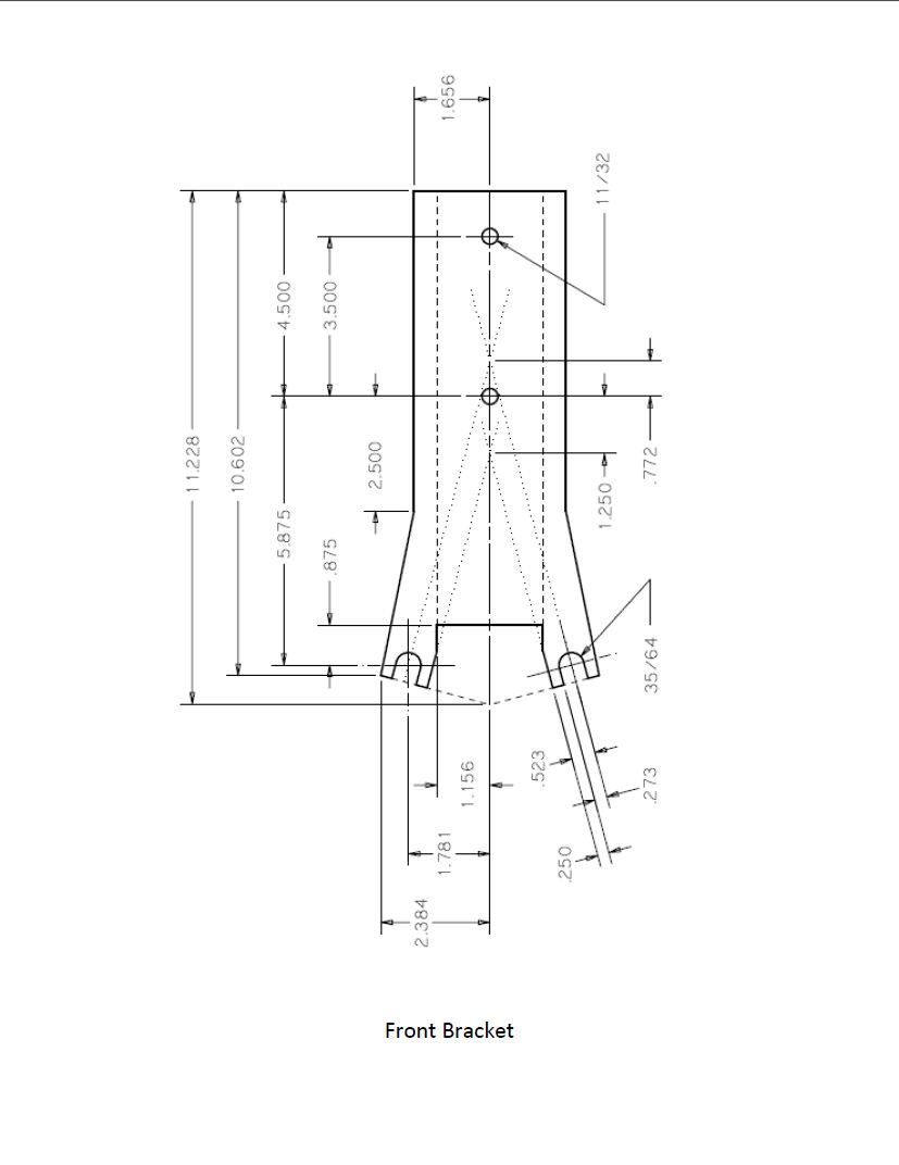

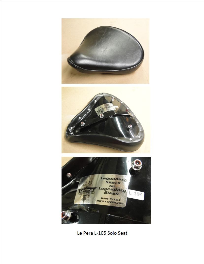

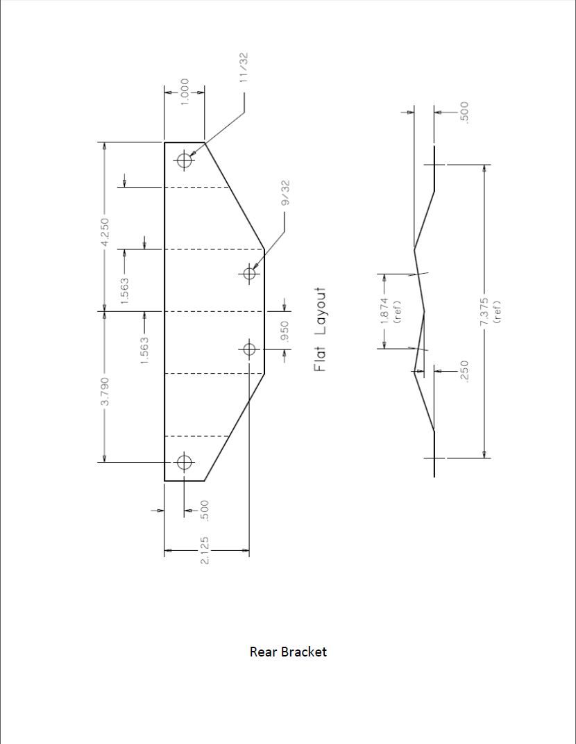

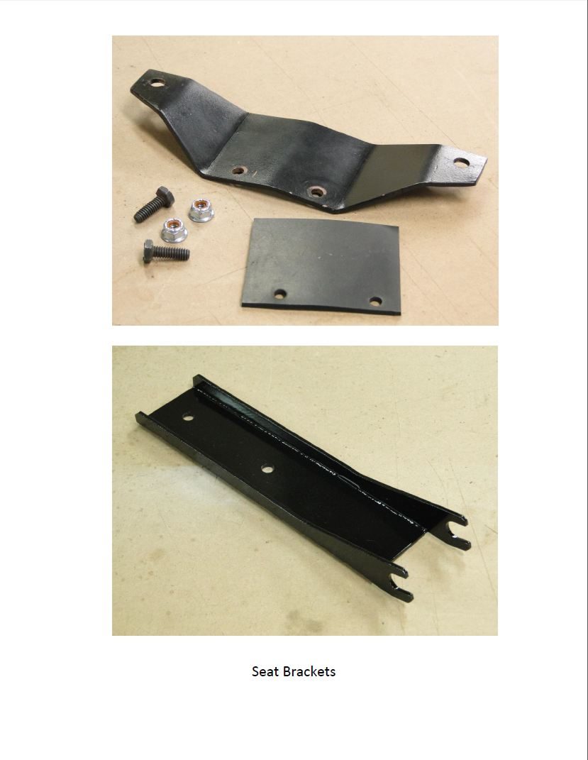

CA77 Solo Seat
Email sent, and the 6 pages should appear below if all goes well...
- Pg6.JPG (60.04 KiB) Viewed 16896 times
- Pg5.JPG (32.4 KiB) Viewed 16891 times
- Pg4.JPG (39.97 KiB) Viewed 16893 times
- Pg3.JPG (60.99 KiB) Viewed 16893 times
- Pg2.JPG (56.45 KiB) Viewed 16904 times
CA77 Solo Seat
Close but no cigar. Max 5 attachments. Here's page 1
- Pg1.JPG (94.58 KiB) Viewed 16898 times
