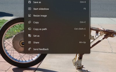

Tommy - Hello from a former SE Kansas CB77 owner. Regarding your struggles posting pictures. If you are using a Windows computer just double click on the picture you want to submit. When it loads there will be three dots ... on the right hand side. Click on the three dots and select RESIZE IMAGE. Change the size to about 1250 and the SAVE AS with a new name that is easy for you to find. Be sure and save the modified pic as a JPG. At 1250 you will be able to load the modified, smaller picture into the forum. I am not a computer whiz so I hope my directions are clear. I'm just a guy who has had this same problem and finally figured it out. I hope this will help you because we would like to see pics of your bike.
