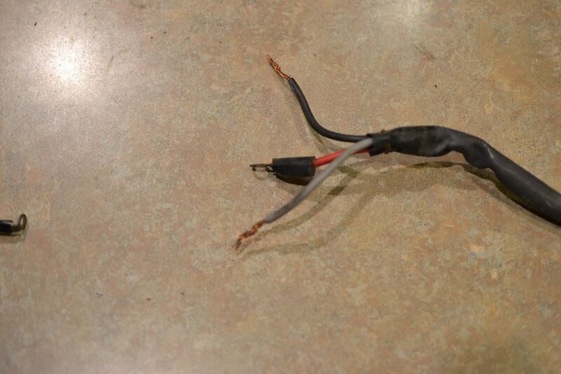

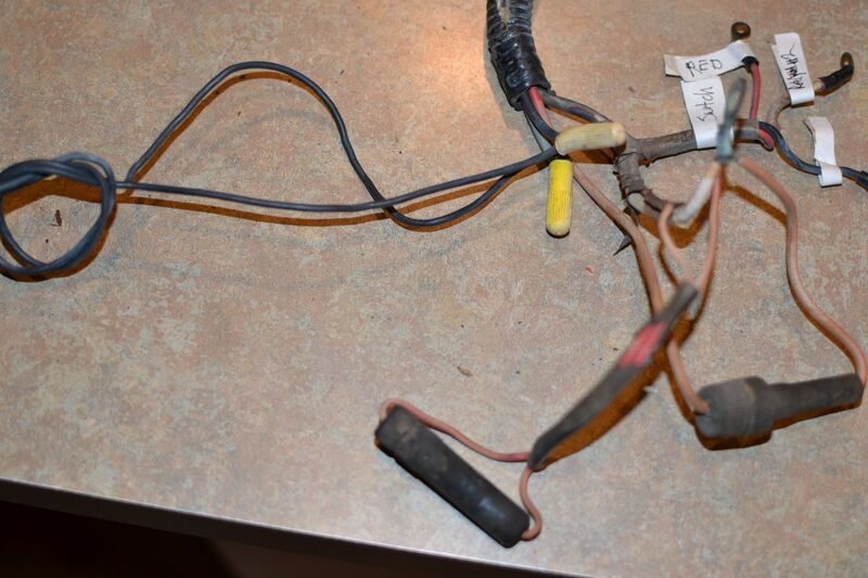

I bought a wiring harness off Ebay, made in Thailand, for a CB77 and I can't find any wires the same color as the original. I am going back to the original wiring harness from 1965 and I really don't think it is that bad. I've got some unaccounted for wires and an inline fuse that I can't find on the wiring diagram and I think have been patched in some time in the past. I think they may be wires for turn signals but I'm not sure. If you would take a look at the pictures and give me your opinion I would appreciate it. There are currently no turn signals on the bike but there are holes in the rear fender so some type of turn signals may have been added.

It's pretty clear that the 'new' wiring is not for a CB77. You do however, have a source of wire and connectors that may be useful in restoring your old harness to working condition.

Best thing I can say is go one wire at a time and take lots of notes.
