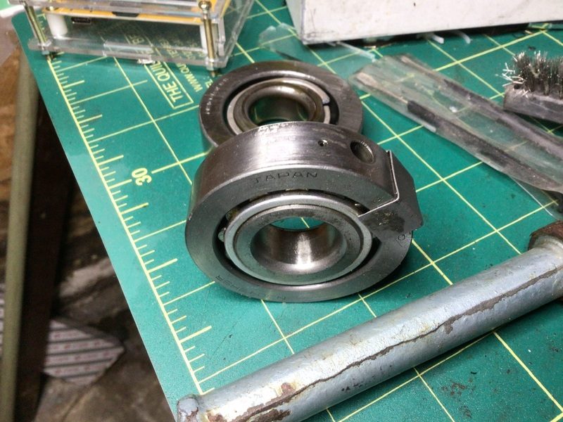

The right side bearing has a hole in the outer race that accepts a pin that locks it in place in the case to prevent it from rotating. It also allows the bearing to resist axial thrusts. I don't remember if the left side takes a pin but the parts diagram doesn't show one. My guess is that if you can find a place that sells bearings they should be able to help you out for much less cash.

Thanks Tim, the bearings both have a locating pin hole and also has a small oil feed hole, unfortunately I’ve already bought the replacement bearings which cost over £200 for the pair. I did try my normal bearing suppliers using the numbers on the old bearings but with no luck.
