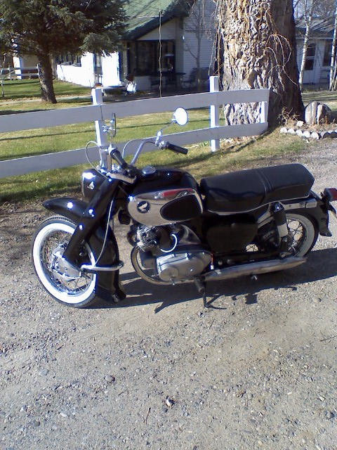

misses under a loadmisses under a loadSo my 63 Dream was running just barely. Missed severely with any more than minimal throttle. Plugs were carbon black. I lowered the slide needle one step at a time until its a low as possible. Did I mention that I live a 5000 feet. This seemed to help quite a lot. When I pull a hill however, it misses again. Checked the timing and it seems OK to me with a dynamic light. I should mention that I was not able to get the proper carb float level as the cross bar which connects the two floats (replacement float) would hit the housing as I approached 22mm.
