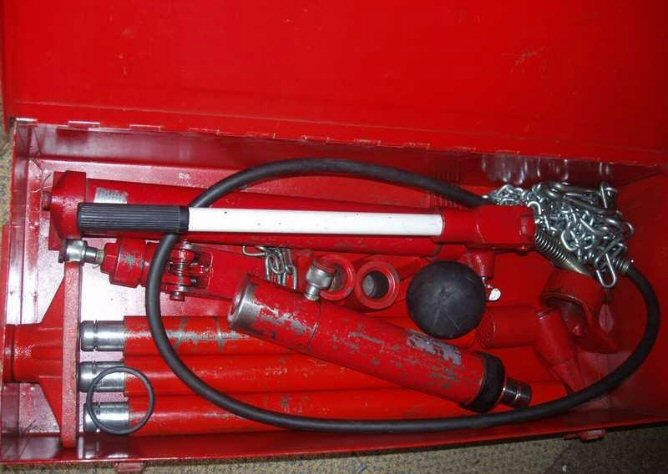

In my world I use constant pressure to press it out, after trying to lubricate it first.
A constant pressure is done by a press, and if lacking one, or it's difficult to place it underneath, I use a hydraulic hand press, or if you don't have one, a hydraulic jack.
I bought a hydraulic hand press years ago, and I used it many times, pressing out bearings, pressing out shafts, straightening frames, forks etc.
hammer = impact = uncontrollable = damage = expensive
I know, it's a little bit of thinking out of the box, but that's me.
Post by e3steve » Thu Sep 02, 2010 11:18 am
Nice piece of kit, J-man!

Post by jensen » Thu Sep 02, 2010 2:21 pm
Hi Steve,
For some reason I think you don't mean any of it. I have the feeling that you find the tools overkill for these bikes, and maybe they are. It was only 100 euro (used), a good investment.
Yes, you can hammer it out, with aluminum or copper rod, but I just don't like hammers, seen too much damage from using them on bikes.
Once I had a superhawk frame which was bend, and I went to a specialist. The guy was asking loads of money for (in my eyes) little work. I decided to buy my own press, and tried to press it straight.
It worked, but it was taking time and frustration (and it is told to me that the CB72 frame is a relative easy frame to straighten).
Anyway, there are more solutions for fixing a problem, I always like to help in a way I know, that doesn't necessarily mean it's the best way.
