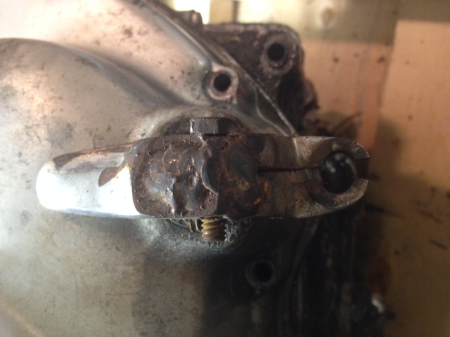

			The part you need too replace is the "Gear Shift Spindle", 24610-259-010.
I have them.  (great used). ....................lm
zads wrote:When I was taking apart the left-side crankcase I realized the gear shift arm had been welded on to the spindle.  I think I found a spindle gear shift through the Ebay seller mistermonkeyclaw, but was unable to track down the gearshift arm. I just wanted to make sure that I was tracking down the correct part, it is called a Arm Gearshift - part # 24711-268-030, right?

			Thanks LOUD MOUSE. I just wanted to clarify that the part with the welding on it in this picture (see below) is the "Gear Shift Spindle" and not a Gear Shift Arm. Thanks for the advice.

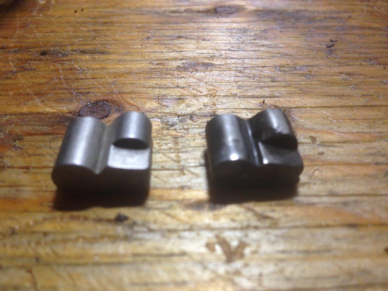

			I took of the oil pump and my missing kickstart prawl showed up! It just fell out, any idea how this would happen? Have you seen this before?
