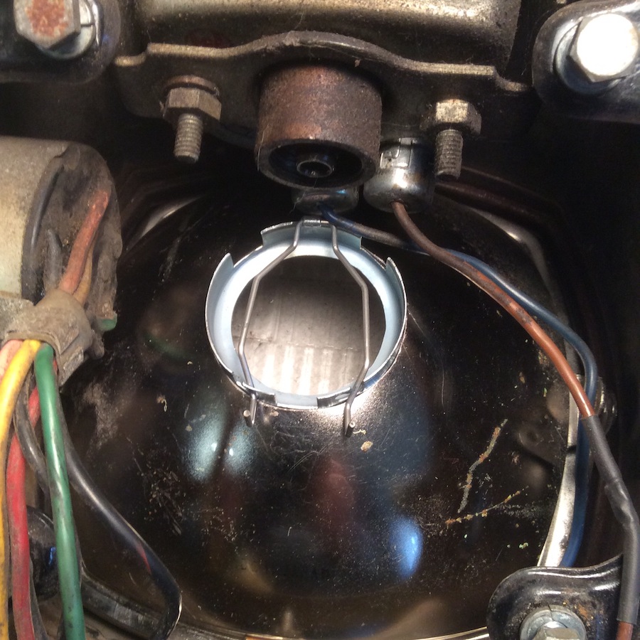

I've finally received an couple of H4 bulb holders and was able to work on this today. The holders were very difficult to find. I tried the local salvage yard, but they would not help unless I told them exactly which vehicle had the holders I wanted. I didn't know, so I went back to the Internet and found some for an old Ford truck light retrofit.
The bulb holder was made to be installed inside the headlight bucket with the bulb held opposite the normal way. I had to drill it out so that the bulb would fit through it.
Holder again.  Not aligned though.
Holder - friction fit
Rough hole cut in headlight backing
Unmodified and modified holders
Unmodified bulb holder

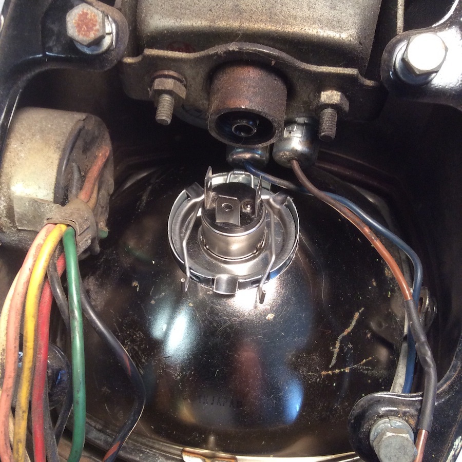

Post by Seadog » Sat Mar 14, 2015 3:33 pm
The holder, then the bulb with the holder with were trial fitted into the headlight bucket. I believe that it will all work, but the light bulb tabs will need to be bent down 90 degrees.
Now I need to permanently fasten the holder to the back of the headlight. I haven't decided whether to do that with solder or heat resistant sealant. I prefer solder, but have to test my steel soldering skills on some scrap first.
Next update with a working bulb.
In headlight bucket with bulb,
Trial fit of bulb with holder only into the headlight bucket.
