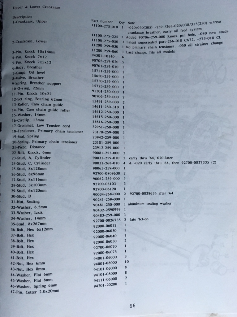

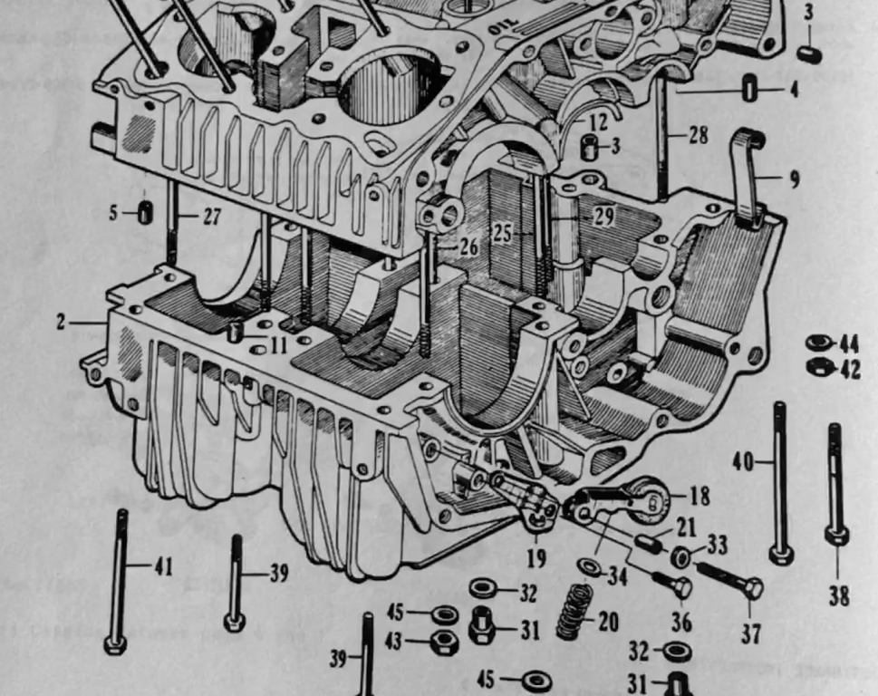

I think you might be looking at a crushed (aluminium) sealing washer which can compress onto the threaded part of the 6mm stud which passes through the main oil gallery. If this happens the washer can usually be screwed off the stud with a pair of pliers and the cases will then come apart. The washer should be replaced every time you split the cases anyway.
Stud 29, sealing washer 32 and sealing nut 31 on the parts diagram.

DJM - I think you may be right. It looks like it is made of the same aluminum as the sealing washer. What is puzzling is that it is on the stud opposite the stud requiring the sealing washer and special nut. Perhaps someone assembled the engine thinking both of these studs needed a sealing washer.
