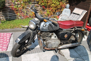

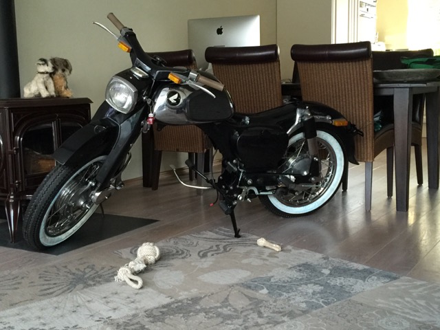

and at this moment I am busy with the restoration of a C77 from 1962. When I bought it it looks like the picture below, at this moment it looks like the second picture, yes the bike is in the living room! I took the whole engine into parts because I would like to do a good clean job.(sorry for my badly english).

now it looks like this
