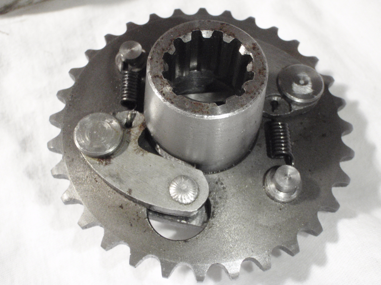

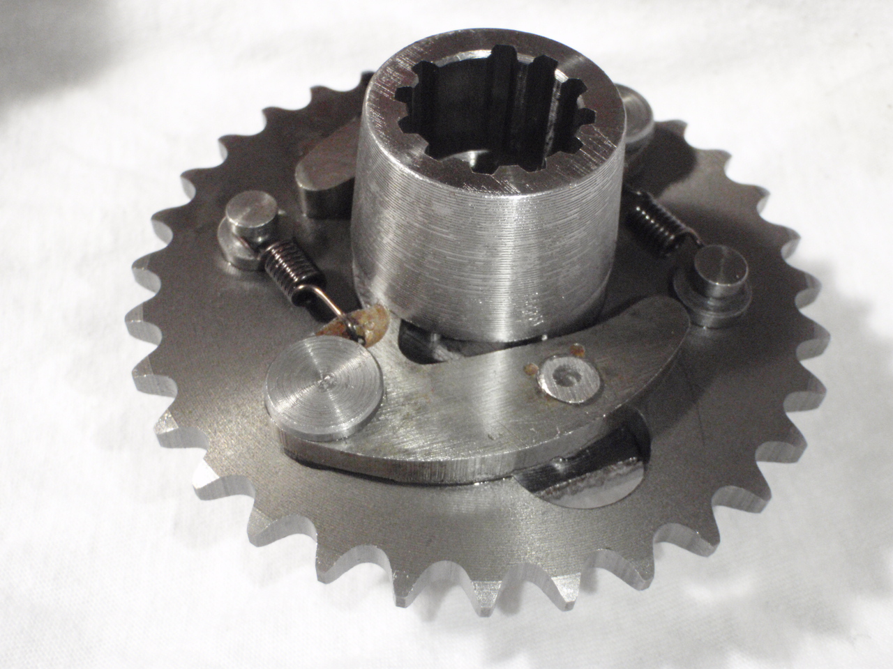

Can anybody explain me what the differences are between a C72 / 77 and a CB72 / 77 cam sprocket other then the length of the advancer weight arms and advancer springs ? (and another function of rpm versus advance timing).
Did anyone used a C72 / 77 cam sprocket in a CB72 / 77 (or the other way around) ? and what are the experiences ?

I think these sprockets can be used in both applications, and probably the dream sprocket is quicker in giving full advance. LM and I agreed on that, any other interesting input ?

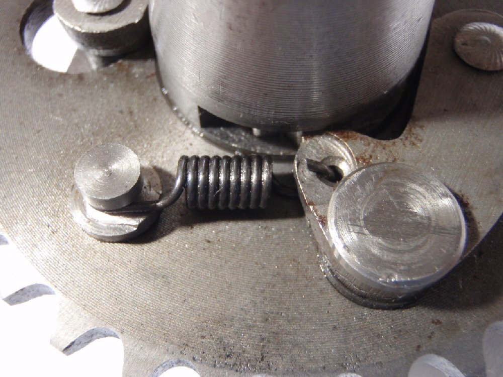

I noticed the right hand thread on my early Dream camshaft but I hadn't looked at the governor weights which your picture shows so well. The Dream weights have extra material so they will advance the timing more quickly than the CB weights which are shorter.
