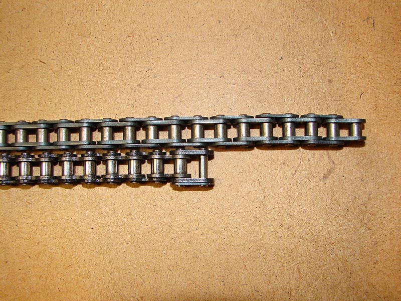

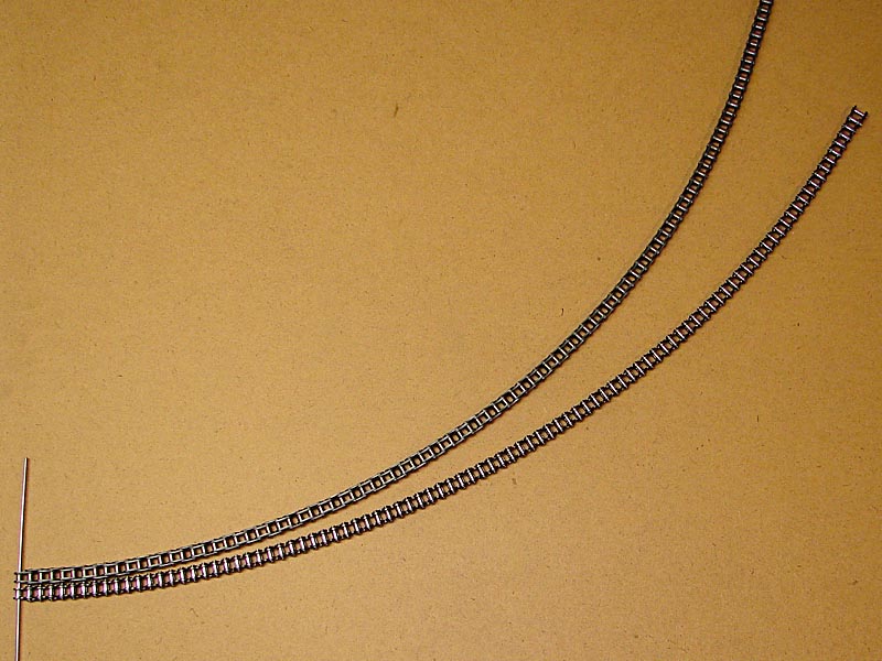

Another step in the refreshing of my CA77 motor... the Cam Chain.
Specs say: Camchain length: 94L 723-723.8 mm (28.46-28.49”) limit 728 mm (28.66”). My DIL K219H chain measured 733.425mm 28.875" which is beyond the Limit so I found a NOS RCK219 chain and it measures 731.850mm 28.813” which is still over the Limit. At first I thought I had bought a used chain, but on close inspection I do not see any wear marks on it like I do on my original chain, and the NOS chain is 1.5mm shorter. Also, when both chains are laid side by side and bent, the Original chain is better than the NOS one.
So... Two Chains, one is the original, one is a NOS, both beyond the Length Limit. The NOS one is about 1.5mm shorter but the original one has less bend.
Which one should I use?
In the attached photos, the original chain is the Bottom one and the NOS is Top and is 102 links which I will cut to the 93 links and Master as the original one is if I use it.
Tnx
George
Tnx
George

Yup, I did read thru that discussion (or at least I found one of them), and I was thinking that I should go with the NOS chain. Thanks for the confirmation.davomoto wrote:Goerge, use the new one. It has been discussed on the forum before that bending a chain like that is not an accurate way to measure wear.
George

The DIL chain that I removed had the peanut side plates and the NOS RCK has the straight plates. I shortened the NOS chain to 93 Links, cleaned it up, and now it's soaking in oil.teazer wrote:Stock style is the peanut shaped side plates which come in a variety of different thicknesses with a variety of pin diameters.
As long as the chain is new it will probably do for street use.
Havin Fun Now :-)
tnx
George
