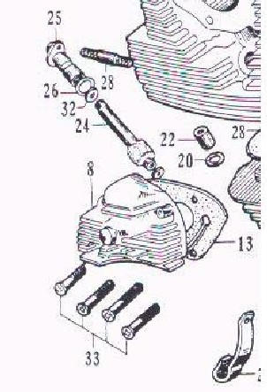

does anyone have a part number for the tach cable seal? mine is missing the seal and leaks. or does anyone have one to sell? the parts catalog doesnt show one.

are you referring to the o-ring (#26 in the diagram) or the bushing inside the cable itself?

The seal at the tach cable end was/is part of the cable and not available as a separate part. ......lm

I'm looking for the seal in the cable itself. Does anyone have a spare or can someone measure their part so I can try to find a close alternative?
